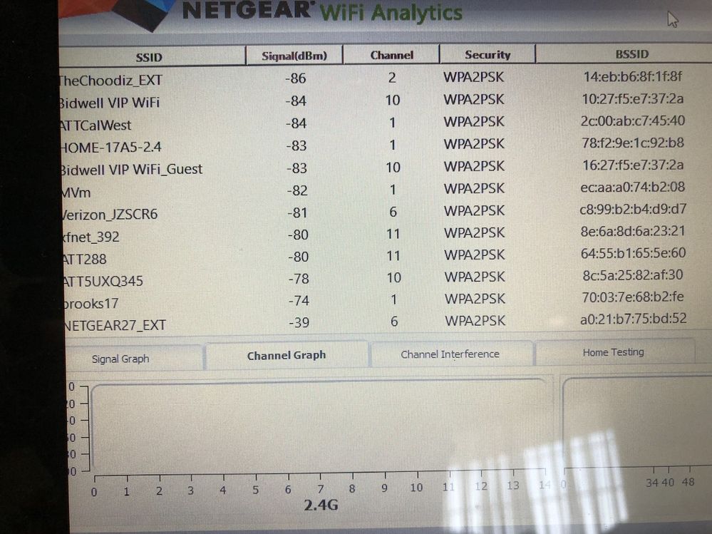

It being a vacation house, just got a chance to visit and respond. I have a Linksys CM3016 cable Enclosed is the surrounding WiFi. Changed my channels to 3 and 40 Did the restart of everything from scratch and set the DHCP IP as stated. Surprisingly, when I was setting up again, it’s only the router operating and no satellites yet connected, my devices were all connected albeit the distance ones weak, -80dBm+. With the satellites properly spaced and positioned, strong signals to everything. So, no just have to wait for the next lengthy power failure and hope everything reboots and reconnects

Kinda busy around there.
Primary channels to use are 1, 6 or 11. Others are 2ndary used by the wifi system. You might try channel 6.
