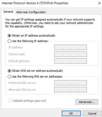

Hi plemans. thanks for your reply. My PC is set to receive DNS server address from the router, which is set to 208.67.222.123 The problem is it that the MR60 despite being in AP mode seems to be setting it to 8.8.8.8. I know it is supposed to be disabled in AP mode but it isn't. That is the problem.
And by the way many of the functions listed in the document at that link are not disabled such as Guest Network, Access Control and Parental controls are available in AP mode on the MR60
