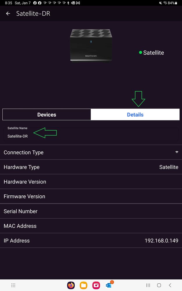

So I found this hidden process on my Android pad with the NH app.
Press on the "Satellite Name" section seen here with a finger touch while on the Details section of the NH app:

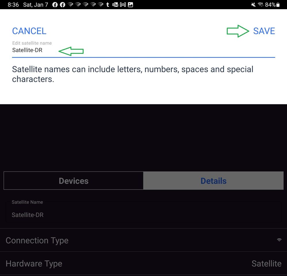

Should bring up the Edit Satellite Name screen:
Press Save when done.
Can you do this as well?

Haha, well, unfortunately, that's exactly the "present but non-working" method in the app that I was talking about. I can enter a new name there, tap save, and then... it just kind of gets ignored. The change isn't applied/doesn't propagate anywhere at all; the satellite name remains default in both the app and router web page.
