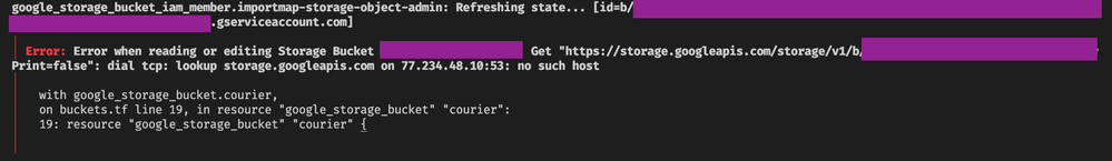

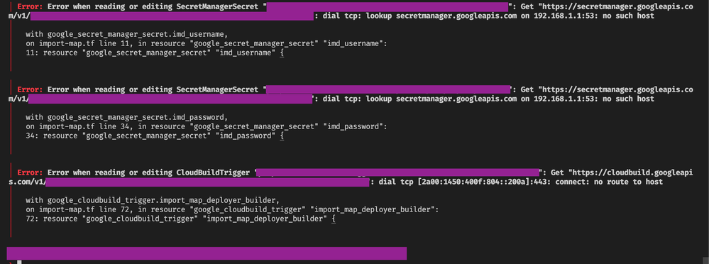

My Nighthawk MR60 drops using terraform aka multiple connections at the same time
I have been working from home the past year and when my work started using terraform I started seeing strange issues with how my internet behaved. There are supporting pictuers I talk about, in the bottom of this post

So, I have done some tests. First of all using my mobile net to verify that it works on wifi and not a computer problem, and that worked completly fine. Never seen any issues there.
Then I plugged into the router with a cable, the same issues was there.
Then I plugged directly into my ISP internet, bypassing the router, and the problems dissapeared.
So I just wonder where to go about this? Is the router failing, why and what can I do?
