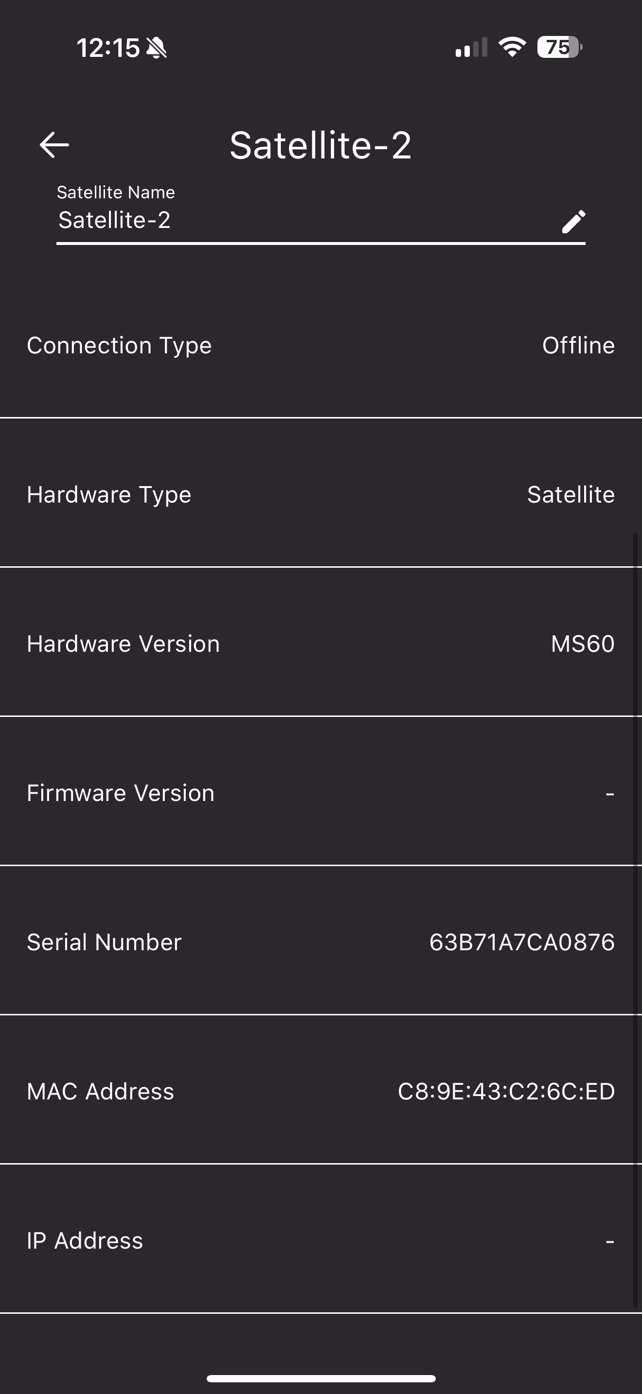

NetGear MR60 Mesh satellite will not sync after power flicker
The power flickered today and I noticed some things not reconnected. Rebooted the wifi and some come back and others did not. Dug a little deeper and noticed one of the satellites not connected. I have unplugged, re-synced, reset and now its currently plugged directly into the router. Still nothing. The firmware on the router and first satellite is current but the second satellite does not show a firmware at all. Any help would be appreciated thanks.

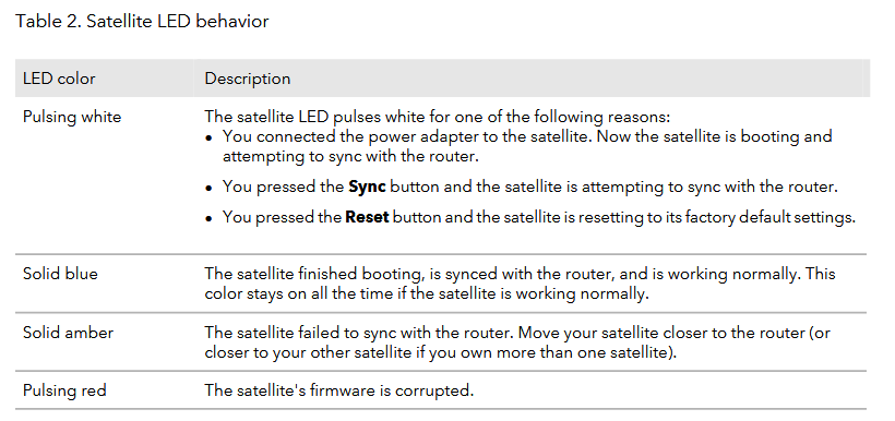

    Sometimes even a brief power "blip" can fry electronics.  One test is to swap the power supplies for the satellite that and the satellite that is not working to see what happens.
    What does the LED on the front of the satellite show?
