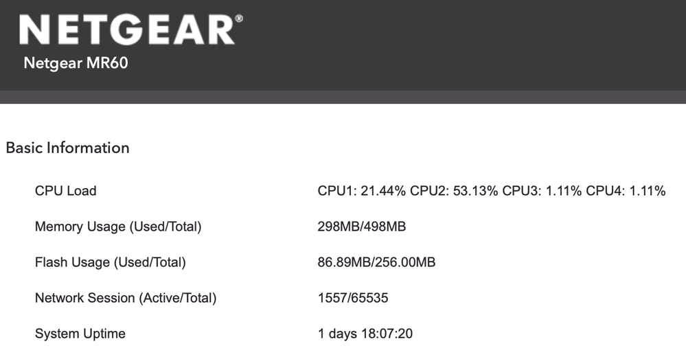

- FURRYe38Nov 16, 2022Guru - Experienced User
- FURRYe38Nov 19, 2022Guru - Experienced User
Put my MK63 online in AP mode with v.132 loaded. Working 1+ days up time:
All 32 devices are connected.
