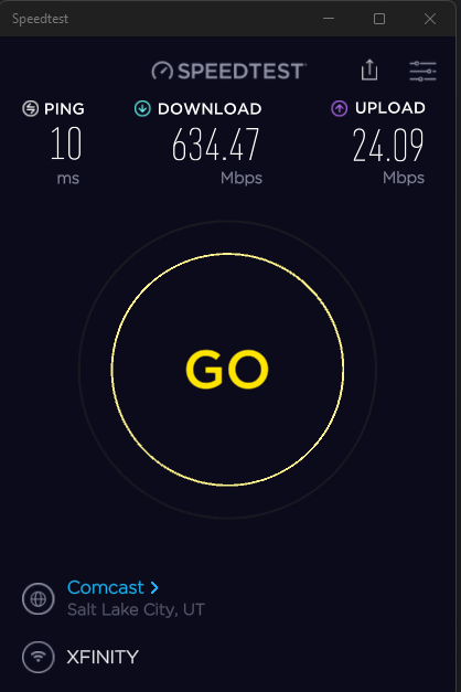

Very frustrated with this system. I have browsed through the forums and nothing seems to help. Firmware is V1.1.7.132_2.0.64. I have a Arris SB6190 cable modem through Xfinity. Wired from the MR6...

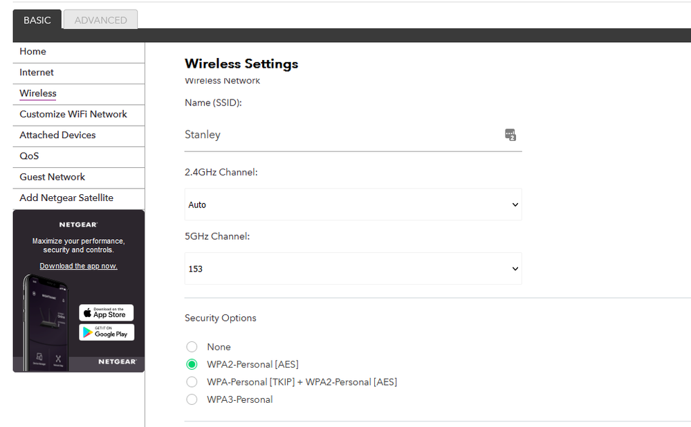

I'm using channel 153 on the 5GHz to avoid conflict with neighbor Wi-Fi in the 44-40 range. I posted an image of my Wi-Fi analysis in the original post. 2.4GHz is set to auto.Security is set to WPS2-Personal [AES]
I'm not sure what you're looking for on the Advanced vs. Basic Wi-Fi settings.
Screen shots would be good here for these two items.

I did change the Power plan on my PC from Balanced to High Performance. This gave me a boost of around 130Mbps
