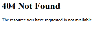

- Chainsaw801Jan 03, 2023Aspirant
That's the problem. I can't log into the MS. When I click manual update and click on the MS, it launches a new window to prompt for my credentials. I input the creds and it accepts them then goes to a 404 error.
http://192.168.137.2/start.htm?page=upgrade_page- FURRYe38Jan 03, 2023Guru - Experienced User
Is that the IP address seen on the MRs web page under Basic/Connected Devices for the MS?
Is try just the IP address alone 192.168.137.2
Just curious is the MS using 192.168.137.1 as it's IP address and spool string? Normally it should be 192.168.1.1 or .0.1...
