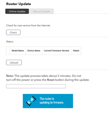

Okay, I got it working to where I can update. I forced a password change on the main unit and now I am able to log in. Weird.
I will update the firmware on all three units and post my findings. I think it's important to keep these threads updated in case someone else runs into the same problems.- FURRYe38Jan 03, 2023Guru - Experienced User
Be sure to update the MS first the MR lastly. Try a full power OFF of the MR and MS for 1 minute then back ON afterwards.
- Chainsaw801Jan 03, 2023Aspirant
Got the MS both done, and the Router (MR) started the update on its own once they rebooted.
