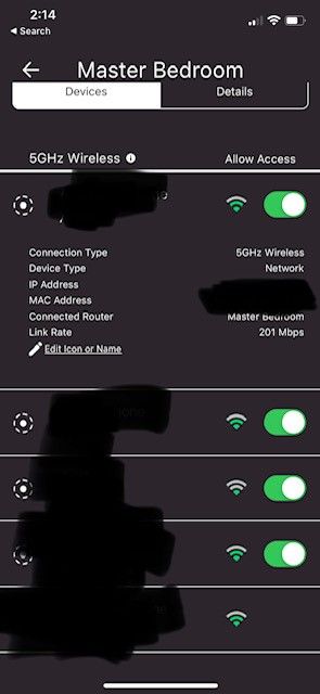

Also worth Noting that through the netgear application, checking the device that is connected to the MS, even though the device is connected to the 5GHz band, the link rate is significantly low. Currently the link rate of a device connected is 211Mbps.
Nov 30, 2022Guru - Experienced User
Can you post screen captures of the MS connection rates and devices connected to the MS.
Did you do a full factory reset and both MS and MR and setup from scratch?
- bulldog00Nov 30, 2022Apprentice
Full reset was done on both MR and MS.
Here is a screenshot of the MS i am currently connected to. You can see there are only a handful of devices and you can also see the link rate i was referring to.
