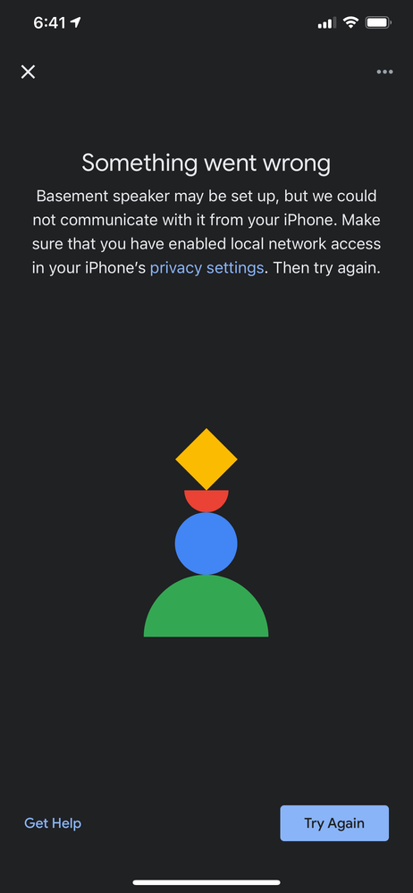

I have 7 Google Nest Minis (speakers). I setup my new network with the Nighthawk M60 mesh wifi system. I named my SSID the same as my previous. I tried using the Google Nest Minis and they work very intermittent at best. So I decided to see if I could just run through the setup process through the Google Home app. No luck. So I read multiple places that I should factory reset them and try running through the setup with the Google Home app. I have tried that. It will run through the entire process. I hear a noise, I accept the agreements, I select my wifi network, then click next. I get a screen that says connected, then I get this error screen:
Google Home app error message
Error Message
I know it is trying to connect to the 5GHz band... but I believe it needs to connect to a 2.4GHz band? Any way to force devices to a certain band? This is pretty frustrating. Right now I have 7 paper weights. Any help would be appreciated!

      Hi subieguy2,
      The Nighthawk MR60 is a mesh system does not support the feature of separating the 2.4GHZ and 5GHz bands.
      Christian

        Hi!
        Not saying it works but can they connect to the guest network?
