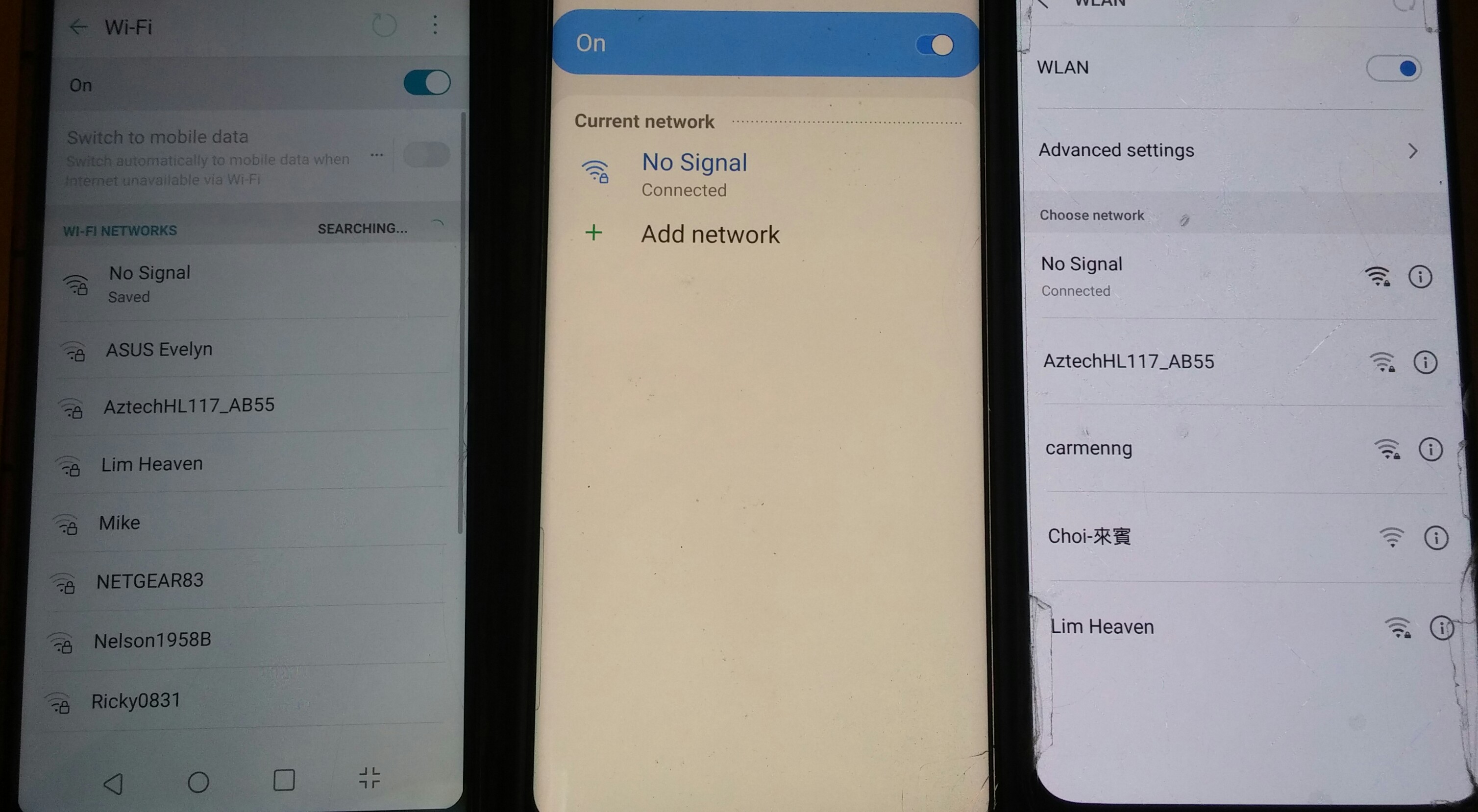

- teafortodayApr 30, 2020TutorUsed the router with older firmwre version in these days. I found out the connection problem is mainly on LG G6 smartphone. The wifi discconects frequently but doesn't connect back to the wifi successfully each time it tries to reconnect. Of course the wifi signql strength is excellent.
When the LG G6 smartphone disconnects, it shows "saved" in the status. When it tries to reconnect, it usually gets back to "saved" , and tries to reconnect again and again until it connects successfully. Sooner it connects to the network, it will discoonect soon.
For the other smartphones, it seems the connection is rather stable during these days.I didn't see the disconnection that frequently.
*LG G6 is the leftmost phone in the photo
