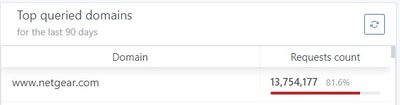

NightHawk MK63 generating a lot of traffic
Hi there, I've noticed in the logs of my firewall, that both MR60 and MS60 are generating a huge amount of traffic to netgear.com domain. This doesn't affect the bandwidth available as this is I...

7.000.000 requests on my side, really noisy and annoying...

Same - this is unacceptable, phonein ghome 90,000 times every 24 hours isn't a small bug.

Mine is hitting
devicelocation.ngxcld.com
time.nst.gov (set me time server to this for testing)
Roughly 85,000 times a day, bith my MR60 and MS60 are doing this, i've tried going back a few veriosn of the firmware and still doing it.

Christian_R appears the DNS resolver code in place does not do any caching, otherwise it would not query the DNS again for the default TTL, which is 86400 secs (1 day) for www.netgear.com [resp. default TTL = 900 (15 mins) for netgear.com SOA].

What ever the design intention is to do some Internet connection test every or every other second - this is what is _really_ going on there. But this implementation is multiplying the traffic .... DNS query .... ICMP .... both can't be right.

Still no new firmware - Why?!?Wating for something pushed for a live update? -> MR60 / MS60 Firmware Version 1.0.6.112 - Hot Fix available for a few days already.
- Bingoig11Jul 06, 2021StarJust deployed the fix on router and satellites.
Seems that constant requests are stopped but will monitor it tomorrow. - Chilli71Jul 06, 2021AspirantChristian_R

Would disabling 'get IP via DHCP' and static DNS be a work around?Scratch this idea. The heavy DNS queries came from the satellites, and happen under any condition. The hotfix referred already is supposed to address this problem.
- Bingoig11Jul 07, 2021Star
After having a look on firewall logs, seems that I can confirm that issue is now resolved. ICMP requests have decreased dramatically.
Still some of them but I assume this is a normal behaviour.
Nevertheless, the time to get this fix is unacceptable...
