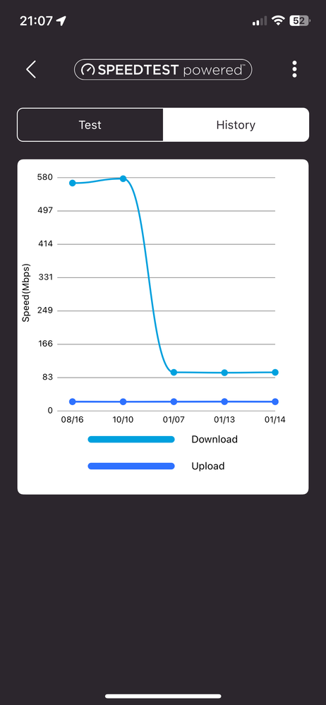

- luga13Jan 31, 2024Guide
this is how it looks, nothing was changed, removed, same cables
- schumakuJan 31, 2024Guru - Experienced User
This does lead to the impression that the Ethernet connection connecting to the cable modem or ISP CPE had re-negotiated to just 100 Mb/s (has lost one of the additional copper pairs), e.g. due to a cabling or contact problem.

The graph slightly below (or around the 100 Mb/s level) in the App tells me the same.
Cable, connector, installation, and very unlikely a hardware issue on the MR60.

- luga13Feb 01, 2024Guide
no worries, i posted a photo above...the last speed test i did at 500MBPS was in October then now in January 2023 i tried again and it was only 90ish..
