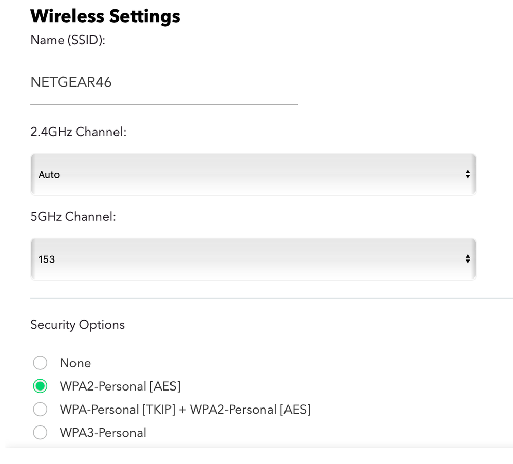

https://kb.netgear.com/000061709/Where-should-I-place-the-Mesh-WiFi-satellite-of-my-Nighthawk-Mesh-WiFi-6-and-Tri-band-Mesh-WiFi-6-products 📡What channels are you using?
Any Wifi Neighbors near by? If so, how many?How is advanced wifi configured on the MR?

one or two wifi neighbors
yes i factory resetting the system and setting up after update
