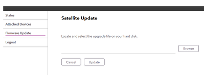

Feed that IP address into a browser so get to its webpage (GUI).
That should get you to this:
Then just follow the instructions. It is a lot like this:
How do I manually upgrade firmware to my NETGEAR router? | Answer | NETGEAR Support
Tell the GUI where to look for the firmware.
