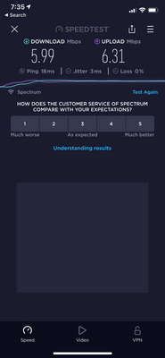

Overnight speed drop. ax3600 MR80. Anyone?
Hello, So I installed a ax3600 / MR80 on 07/20/21. Did a manual firmware update to the router and satellites. since the auto update wouldn't find the new firmware. now the installed version is V...

- in2ndoJul 23, 2021ApprenticeThe reboot took care of it. It’s been fine all day. But I also updated manually to the new firmware 1.1.6.4 . So I guess I’ll have to wait and see how is tomorrow morning.
- in2ndoJul 28, 2021Apprentice
Akomix wrote:Interested if you find a resolution, running into something eerily similar.
Wondering what version are you running? after I upgraded to 1.1.6.4 it seems it was working ok. I had to downgrade back to V1.1.5.4_3.1.91. because of a different issue and today it happened again. just like last time. I get a message that the router found a new device (my ring doorbell pro) even do it was connected from the start. and after that. the speed today was below 7Mbps. until I rebooted.
