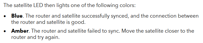

Hello everyone, I've had my MR80/MS80 for 6 months without any problems. However, yesterday, I noticed one of the satellites in my garage continuously switched between orange amber and blue lights. A...
- Jan 27, 2024
Interesting that the User Manual (page 15) shows only two colors:
Usually the first question is, "What Changed?". Could be something as simple as placing some object in the path between router and satellite (garages often are used to "store stuff" and WiFi is sensitive to passing through materials.) Or, the orientation of one of the devices could have been changed.
The units have both been rebooted?
What is the physical distance between router and satellite?
