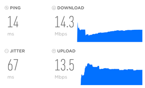

Hi, I am looking for some help as I am getting really slow wireless speeds from my MR60 mesh wifi. We are in the UK we have OFNL fibre broadband provided by Ashford, up to 900mbps. We the...

Wired to the router I get:
Ok so we know wired is GOOD.

- our sky boxes have their own wifi network, otherwise there are no other wifi networks in the area. What happens if you turn these sky boxes and all bridged OFF? I'd turn off all wireless devices and test with just one Iphone or pad with the MR and see if speeds are still low.
