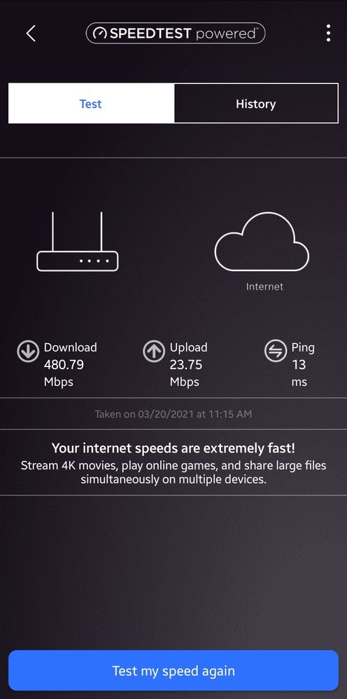

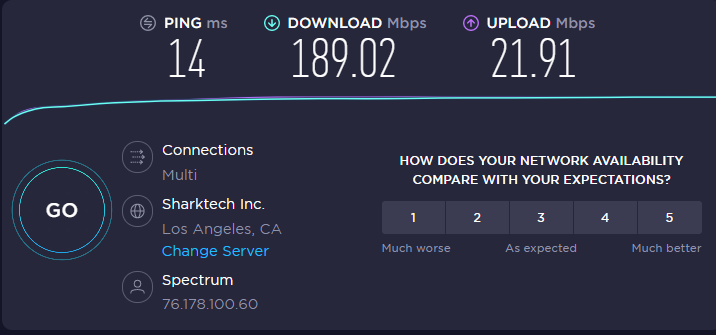

1) I'm experiencing about a 65% speed loss off the top as compared to hardwired speed. I'm on Spectrum in Southern California, and when hardwired, I see speeds of ~480mbps. The Netgear Nighthawk app reads the same (see attached). However, on a laptop about 5 feet from the main router, I consistently test between 150 and 190mbps.
Nighthawk App Speedtest
Laptop (<5ft away) speedtest

    Are you testing over 2.4ghz or 5ghz?
    2.4ghz is going to be slower than 5ghz.
    Have you logged into the MK system and checked to see if you're attached to the satellite or the router?
    You'll see slow speeds attached to the satellite as its a dual band system and not triband.
    Also what device and site are you speedtesting on?
