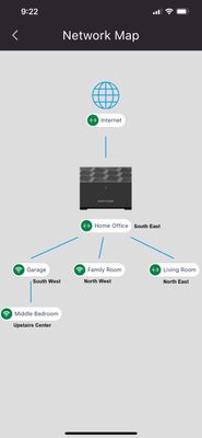

I have a WiFi Mesh setup at home with 1 MR60 and 4 MS60s connected to it as shown in the attached picture. I have Wired Connections from Home Office where MR60 is located on South East corner to Fami...

Hi FURRYe38 , here are answers to your questions.
V1.1.7.134_2.0.65
Netgear CM1100
Be sure your using a good quality LAN cable between the modem and router. CAT6 is recommended.
I believe it is CAT6 as I used the cable that came with the Router.
What is the size of your home? Sq Ft?
2400 SFT.
What is the distance between the router and satellite(s)?
I would say it is easily 25 - 30 feet as these are at diagonally opposite corners of my home.
I don't think the distance is the issue as these are working fine at the exact same spots when connected wirelessly. Moreover, when I connect only one of them from either of the locations through, wire and leave the other Wireless, it works fine. That means, the wiring and the switch it is connecting through should be fine. It gets into problem when I connect 2 of them through wire. I am trying to figure out why.
What CAT# lan cable are you using? CAT6 is recommended.
Yes, it is RoHS compliant Cat6 cable connecting these rooms.
What is the Mfr and model# of the ethernet switch in the configuration?
Netgear ProSafe GS110TP

Does the MS show as wired connected status on the MRs web page or the NH mobile app under Network Map?
Have you tried swapping MS locations with each other to see if the same thing happens or follows the MS?
Possible your Switch could be a factory. Thats a semi managed switch. Might try a non managed switch, like NGs GS10x series.

I have a suspicion the 2nd one might be the culprit; keeping my fingers crossed.- msekarMar 28, 2023Aspirant
FURRYe38 Thank you so much. You nailed it.
The culprit was Netgear ProSafe GS110TP. I swapped it out with Netgear ProSafe GS108 and reconnected MS60s in Family Room and Living Room through wire. They started working and the other 2 MS60s are connected Wirelessly as there is no drop there. I have the home network the way I want configured.- FURRYe38Mar 29, 2023Guru - Experienced User
Great to hear.
Possible that couple of items on the GS110 could be effecting the MS, IGMP Protocols and GreenEthernet features. Can check the switches web page for these and disable them and see if the MS will connect properly. Or leave the GS108 on.
