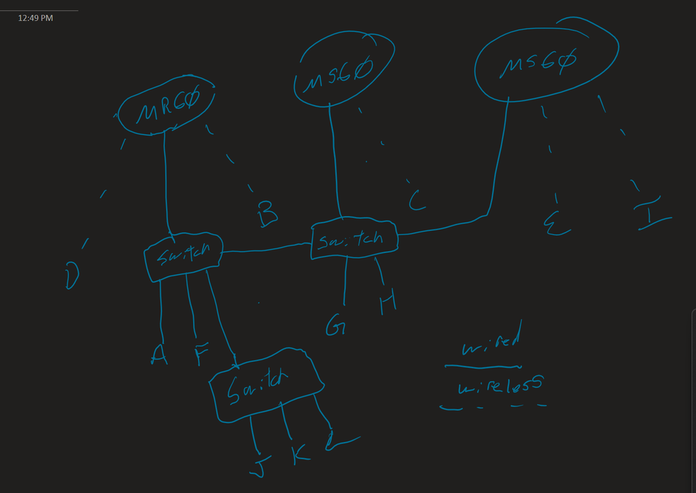

It is clear you have no clue about networks and how they work, so stop trying to answer this unless you actually have an answer. This isn't about public networks, and this isn't about mobile devices. This is about a secure internal network, where everything works as it is suppose to EXCEPT when both devices connect to the same wireless access point. Do to some issue with the system and I am looking for a fix. Either a good one, make it work correctly, or alternatively make a device always connect to a specific access point so I can keep the devices that need to see each other and accessing each other to do so.
Maybe you need a picture...
So in this sketch D can see and work with every device but B, B can see and work with every device but D, E can work with every device but I, I can work with every device but E, and then A,F, G, H, J, K, L, C, can all work with every device. I need D&B to be able to work with each other, I need e&I to be able to work with each other. There is something going on, which hopefuly is just a setting that is making the MR60 break the network connection between two devices when both are connected to the same wireless access point. making them as if they were on separate networks/subnets even though they are clearly not and every device not wirelessly connected to that access point can see both B & D just like they are suppose to, just B&D can not see one another. (not 100% sure about e & I as I haven't tested to be sure if issues happen when both are wirlessly connected to one of the MS60s, but it happens to the MR60) Further I thought at one point I found a setting and got it fixed and then after an update it went back to this broken behavior and I can't figure out how I fixed it. So am asking the community.
