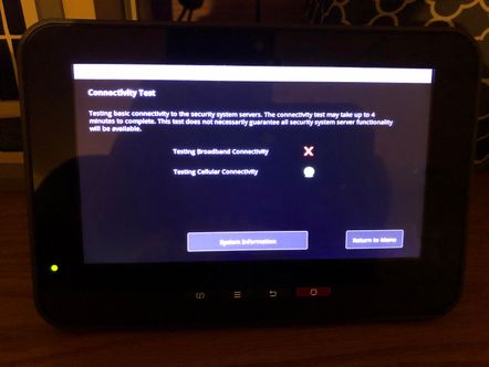

The Comcast WNR1000 router is for my home security system as backup communication I believe. There is also a cellular connection for the system, which is still connected. See attached screenshot.
I tried connecting the WNR1000 directly to my laptop, but the usual 192.168.1.1 and www.routerlogin.net yield no successful connections.
So, I wonder if I really need it when I have a cellular connection, also can only imagine how outdated its firmware is, too.
- shanafanJun 06, 2019ApprenticeWith the Comcast router disconnected, my home security works but I can’t arm the system from my phone anymore.
If interference from being in close proximity to my XR500, what if I got a range extender with an Ethernet port and place the Comcast router somewhere else in my house?
