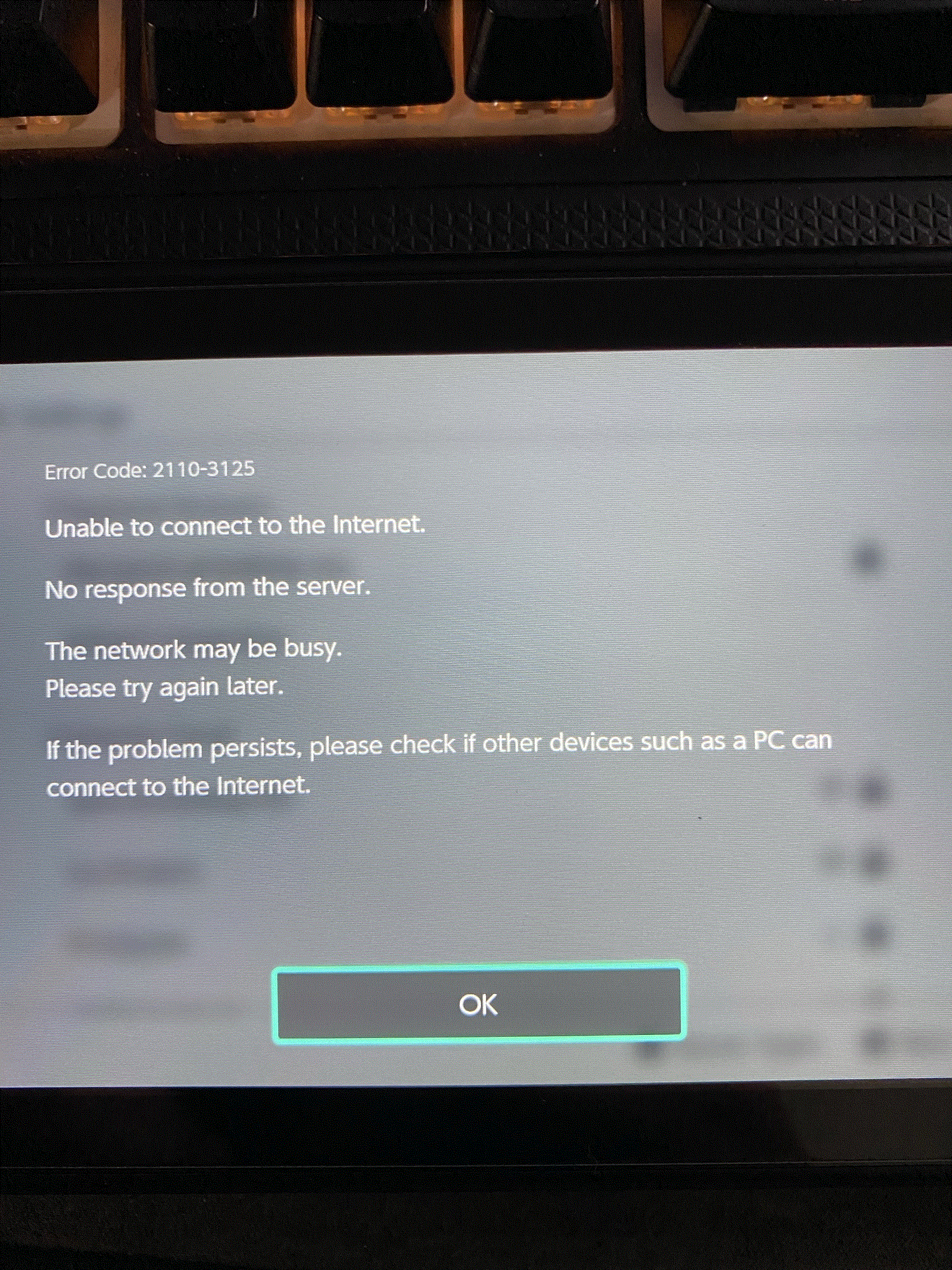

Cant connect switch to XR100 wifi
For some reason, i still cant connect my switch to wifi. I have been at this for months now and still no solution. Nintendo says its the ISP, then ISP says its netgear. Just going arounds in cirlces....

So I am able to connect to wifi (router), but not fully connect to internet. I’ll start with that the switch is only 3 months old, bought from target in store. I used to have a spectrum modem and router and it would connect without any problems. Then got the Netgear modem (cm2000) and router (xr1000) and the switch stopped working. I am able to take it to my Dads, brothers, other brothers and connected to wifi with no problems.
- Netduma-FraserSep 16, 2021NetDuma PartnerOkay great thank you for clarifying. Does it have any sort of message or error when it tries to connect to the internet but can't?
Do you have Armor enabled on the XR? Try disabling QoS fully from the Congestion Control 3 line option menu and see if that allows you to connect. Have you added the Switch to the Geo-Filter?- mikez0rSep 16, 2021Tutor
I jusst turned off QoS and tried to connect and still get the same error message on the Nintendo Switch. (i uploaded a picture.)
Armor is not enabled, and The nintendo switch is not added to Geo-Filtering.
