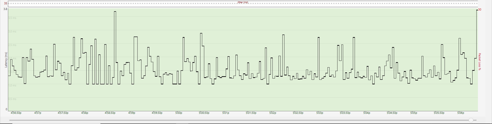

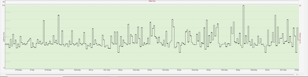

Hey, so I just ran ping plotter and this is what I got:
This is my ping with QoS on optimal ( I tried a bunch of other settings too but all looked similar to this).This is my ping with QoS off

- Netduma-FraserMay 16, 2020NetDuma PartnerWhat did you ping? That ping is far too low to be a site on the internet. Did you ping the router IP?
- MoistureMay 16, 2020Tutor
What do you think I should ping? I pinged my router's ip address.
- Netduma-FraserMay 16, 2020NetDuma PartnerA local IP address like the router IP will always be low - unless there is a fault so it won't highlight any lag/congestion issues. Ping a local website preferably or something like google.com but I would try a few different sites as they can vary in their results.

Here's the ping with QoS enabled -
Ping with QoS diabled -
- Netduma-FraserMay 16, 2020NetDuma PartnerAre they both with heavy downloads happening? What QoS settings are being used at that time?
For both I was downloading a game. The one with QoS enabled was the optimal QoS settings.
- Netduma-FraserMay 16, 2020NetDuma PartnerAs in you used 70/70? It needs more tweaking to find the percentage that lowers that ping more and to eliminate those spikes.
