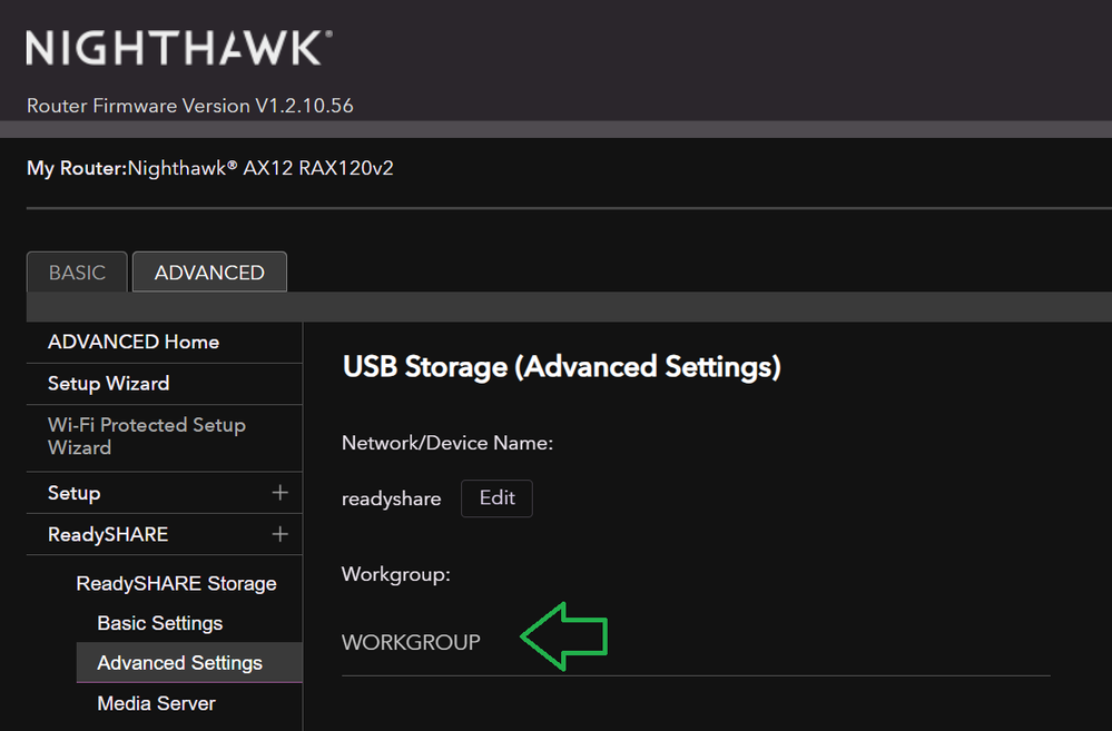

Make sure the Workgroup section is same as what you have on your PC and it's case sensative as well:

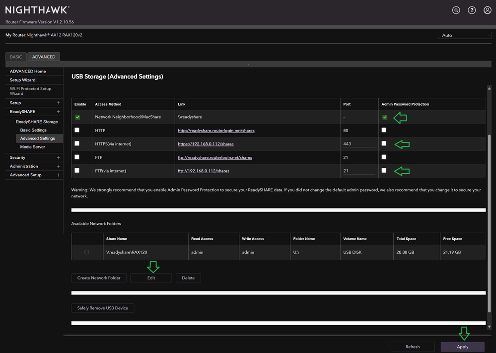

Enabled Network Neighborhood feature and disabled the FTP and HTTP share features.
Windows 11 would not use a log in with out a PW so I had to enable Admin Password Protection:

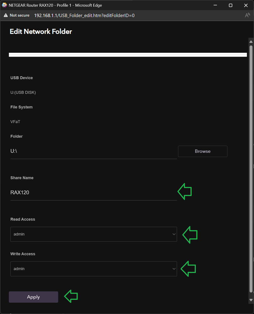

Also set a ShareName then Applied.

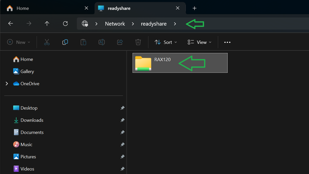

From last caches link in Explorer used \\readyshare was in the list or paste or type this link in and the RS folder appeared in Explorer:

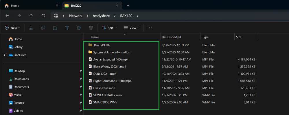

Selecting the folder revealed the contents which are accessible:
So for the RAX120v2 and this most current version of FW, RS seems to be working good with Win11 PC.
