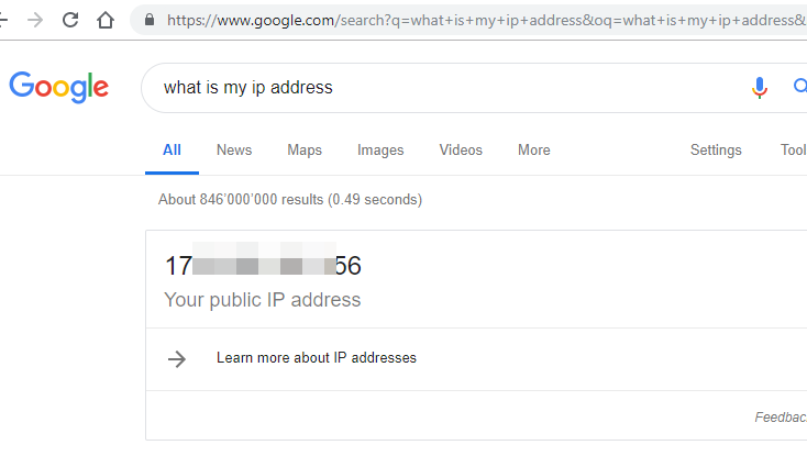

Compare the IP address assigned to the XR500 WAN/Internet port with the Google "what is my IP address" (e.g. https://www.google.com/search?q=what+is+my+ip+address ) with the information visible on the router Web UI - Advanced Tab - Internet Port - Internet Address (when I have it right).
