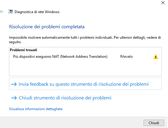

put in the exposed host of the fritz box 7590 my modem the ip wan of the router but anyway I have the double nat how do I avoid this thing given that in gaming
Netduma-Fraser
May 22, 2019NetDuma Partner
Wouldn't advise for a PC. How are you detecting the double NAT? Can you provide a screenshot where it says this please?
Manuellll
May 23, 2019Apprentice
here it is, it's Italian says more devices are running nat
- ManuellllMay 23, 2019Apprentice
can you see the picture? what do you think if you put the nat on the xr from protected to open it could solve the problem?
- Netduma_AlexMay 23, 2019NetDuma Partner
- The Fritzbox must be in Bridge Mode
- If Bridge Mode is not available then the XR300 must be in the DMZ of the Fritzbox
- Copy the WAN IP from the System Information page of the XR300, and paste that IP address into the DMZ setting of your Fritzbox
- Delete any port forwarding rules that you have set up on the XR300
- Make sure that UPnP is ENABLED on the XR300
as I mentioned earlier my modem or the fritz box does not have the dmz but the exposed host which does not allow me to avoid the double nat but have I already put the xr ip and why should I close the portforwarding? UPnP is already active and I can't find this bridge option in the modem
this is the only thing I found in the fritz box about bridge is what did you mean? but beyond the vlan vpi options and vci the rest I have to put?
