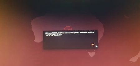

I purchased a Netgeat Nighthawk XR1000 and tried to set up geo filter but whenever I try to chnage radius and change my location cuz it does not point out my exact location an error message pops up. ...

I'm assuming the router upgraded the firmware during the setup wizard if so I would recommend a factory reset from the interface, wait 2 minutes and then access and set up and it should work. Reason being a factory reset clears out old low level code from the previous versions that could cause issues.
