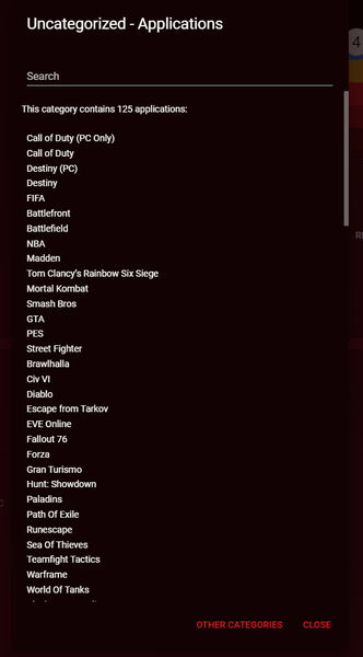

Hi guys, I've just bought an XR1000 and I'm loving it so much. I've set up pretty much of the QoS as I want following the wizards. But I can't find guides/sources on how to prioritize games like ...

I've attached a screen with the most information I could gather, I hope it's enough.

I'm getting a lot of conflicting information online about what ports it uses but do 17000-17100 instead of 17025 and see if it works better please
