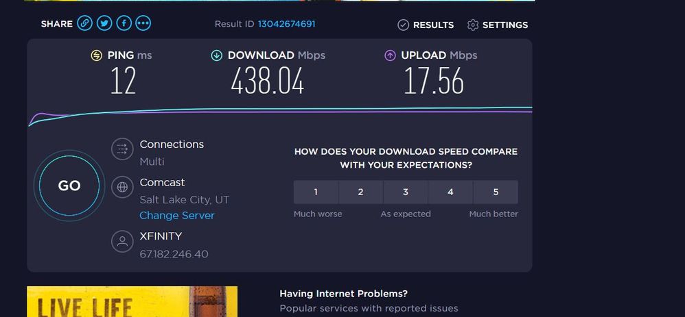

Hey All, I have an extremely slow Nighthawk XR500 (Tested on V2.3.2.130 and V2.3.2.134) that is of course out of warranty. I am paying for 900 mbps which I am getting when wired to my modem. Whe...

Ran some more tests again today and we are back up to the standard wired connection it was before, no difference with qos off.
- Netduma-FraserApr 17, 2022NetDuma PartnerI can't see the picture until it's been moderated, can you attach directly or link from elsewhere?
- my340iApr 17, 2022ApprenticeAttached
- Netduma-FraserApr 18, 2022NetDuma PartnerAs a test, and only for this test, then remove it, please put the PC in the DMZ in WAN Settings then run a speedtest, what do you get?
