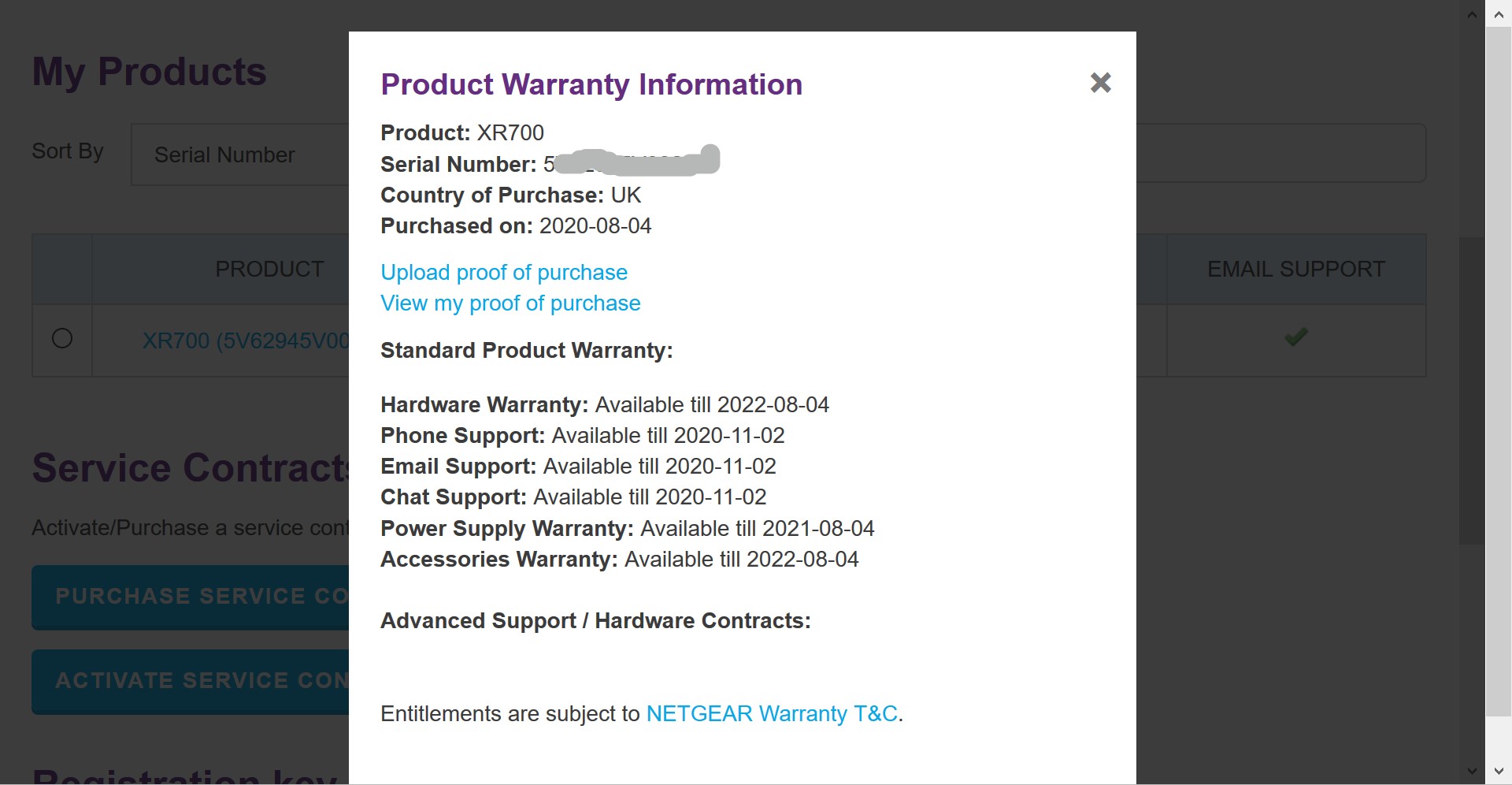

faulty xr700 netgear Terrible Customer Service
It is now 7DAYS later and still no contact! Netgear refused to return the product xr700 my speed test is about half as what they should be directly connected through ethernet I QoS is off then DumaO...

- asus009Aug 15, 2020Aspirant
how can I get netgear exchange the router?
- Netduma-FraserAug 15, 2020NetDuma PartnerMight be worth giving them a call as when in AP mode the DumaOS doesn't function basically so it's not a DumaOS issue so it's either a hardware or Netgear software issue most likely.
