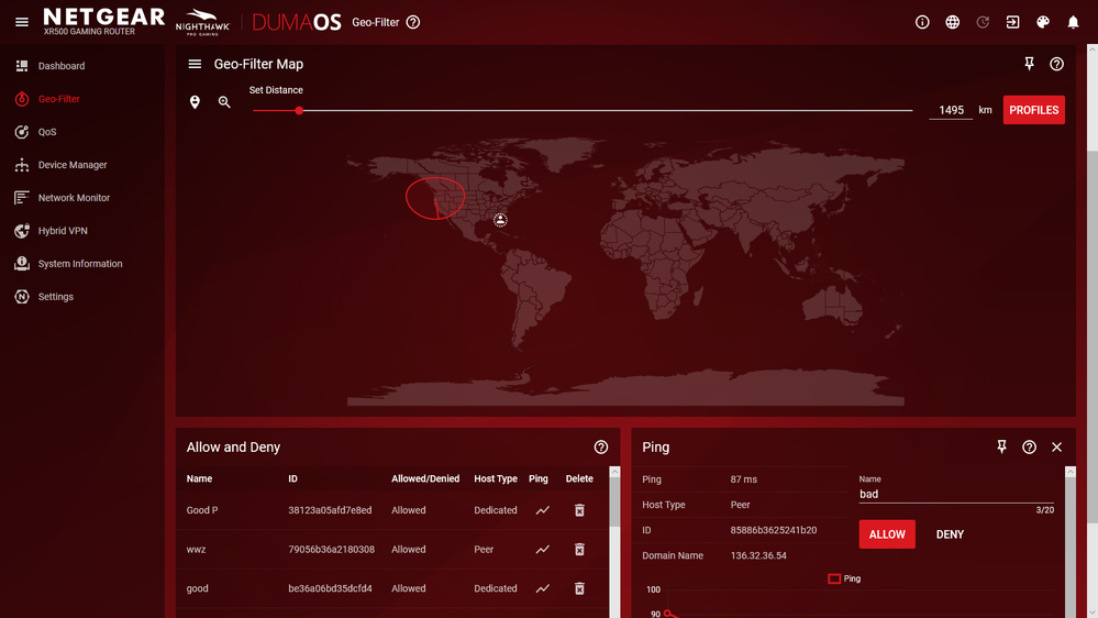

Geo filter issue on XR500
I cant get the router to select an allowed server any more when I pick one it just sits there and will not show the servers and then it just picks its own when a game starts even know I had one set i...

Mark9816
Aug 09, 2020Apprentice
Here is the pick while in a game.

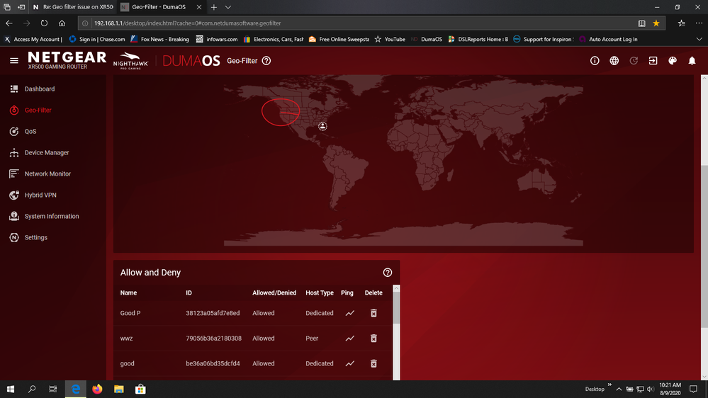

Mark9816
Here is a mucj better pick of what I am talking about. This one shows my denied server being allowed to with auto ping off.
- Netduma-FraserAug 09, 2020NetDuma PartnerCould you upload to Imgur please and post the links here as I can't see them until they've been moderated.
- Mark9816Aug 09, 2020Apprentice
I dont know what a imager is sorry I uploaded to the img thing on this page?? Plus one other thing that you will see in the photos once I can get you one is the fact that the map no matter if auto ping is on or not the maps empety no matter what game I play it used to show people and servers and stuff all over and now there's little to nothing on the Geo map.
- Netduma-FraserAug 09, 2020NetDuma PartnerI meant imgur.com which is a photo upload site but no worries I'll wait for them to be moderated.
To help with that turn off the console completely - not in instant on/standby modes and remove the device from the Geo-Filter. Flush the cloud in the Geo-Filter Map options, wait two minutes then re-add the Device to the Geo-Filter. Setup the radius etc that you want and then turn on the console/search and you should see icons on the map again.
