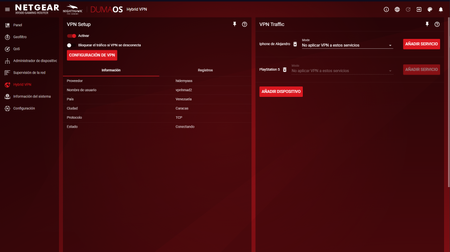

Good evening, I have a problem with the use of Hybrid VPN, I have my subscription to HMA when I put the data, select a city and then select the device that I want to use the VPN the device does not h...

I can't see the screenshot you've attached as it's not been moderated yet. It may be best to add it as an attachment in future.
Have you added your device to the panel on the right-hand side? For more information, check out this guide on our knowledge base.
Feekda
Oct 18, 2021Aspirant
Yes, I added the device on the right, but I still do not have the connection to the VPN.

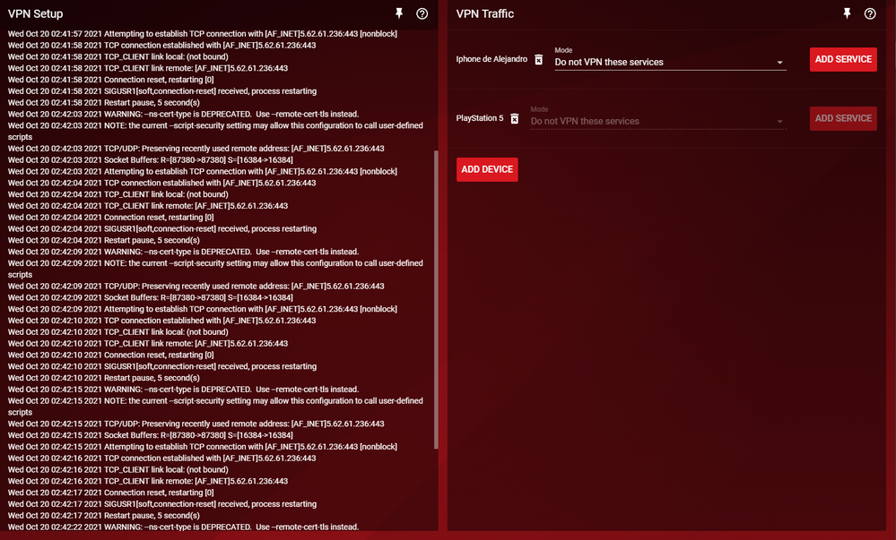

Could you try connecting, then copy the VPN logs and send those over?
- FeekdaOct 19, 2021Aspirant
Wed Oct 20 02:41:56 2021 OpenVPN 2.4.3 arm-openwrt-linux-gnu [SSL (OpenSSL)] [LZO] [LZ4] [EPOLL] [MH/PKTINFO] [AEAD] built on Dec 29 2020 Wed Oct 20 02:41:56 2021 library versions: OpenSSL 1.0.2n 7 Dec 2017, LZO 2.06 Wed Oct 20 02:41:56 2021 WARNING: --ns-cert-type is DEPRECATED. Use --remote-cert-tls instead. Wed Oct 20 02:41:56 2021 NOTE: the current --script-security setting may allow this configuration to call user-defined scripts Wed Oct 20 02:41:57 2021 TCP/UDP: Preserving recently used remote address: [AF_INET]5.62.61.236:443 Wed Oct 20 02:41:57 2021 Socket Buffers: R=[87380->87380] S=[16384->16384] Wed Oct 20 02:41:57 2021 Attempting to establish TCP connection with [AF_INET]5.62.61.236:443 [nonblock] Wed Oct 20 02:41:58 2021 TCP connection established with [AF_INET]5.62.61.236:443 Wed Oct 20 02:41:58 2021 TCP_CLIENT link local: (not bound) Wed Oct 20 02:41:58 2021 TCP_CLIENT link remote: [AF_INET]5.62.61.236:443 Wed Oct 20 02:41:58 2021 Connection reset, restarting [0] Wed Oct 20 02:41:58 2021 SIGUSR1[soft,connection-reset] received, process restarting Wed Oct 20 02:41:58 2021 Restart pause, 5 second(s) Wed Oct 20 02:42:03 2021 WARNING: --ns-cert-type is DEPRECATED. Use --remote-cert-tls instead. Wed Oct 20 02:42:03 2021 NOTE: the current --script-security setting may allow this configuration to call user-defined scripts Wed Oct 20 02:42:03 2021 TCP/UDP: Preserving recently used remote address: [AF_INET]5.62.61.236:443 Wed Oct 20 02:42:03 2021 Socket Buffers: R=[87380->87380] S=[16384->16384] Wed Oct 20 02:42:03 2021 Attempting to establish TCP connection with [AF_INET]5.62.61.236:443 [nonblock] Wed Oct 20 02:42:04 2021 TCP connection established with [AF_INET]5.62.61.236:443 Wed Oct 20 02:42:04 2021 TCP_CLIENT link local: (not bound) Wed Oct 20 02:42:04 2021 TCP_CLIENT link remote: [AF_INET]5.62.61.236:443 Wed Oct 20 02:42:04 2021 Connection reset, restarting [0] Wed Oct 20 02:42:04 2021 SIGUSR1[soft,connection-reset] received, process restarting Wed Oct 20 02:42:04 2021 Restart pause, 5 second(s) Wed Oct 20 02:42:09 2021 WARNING: --ns-cert-type is DEPRECATED. Use --remote-cert-tls instead. Wed Oct 20 02:42:09 2021 NOTE: the current --script-security setting may allow this configuration to call user-defined scripts Wed Oct 20 02:42:09 2021 TCP/UDP: Preserving recently used remote address: [AF_INET]5.62.61.236:443 Wed Oct 20 02:42:09 2021 Socket Buffers: R=[87380->87380] S=[16384->16384] Wed Oct 20 02:42:09 2021 Attempting to establish TCP connection with [AF_INET]5.62.61.236:443 [nonblock] Wed Oct 20 02:42:10 2021 TCP connection established with [AF_INET]5.62.61.236:443 Wed Oct 20 02:42:10 2021 TCP_CLIENT link local: (not bound) Wed Oct 20 02:42:10 2021 TCP_CLIENT link remote: [AF_INET]5.62.61.236:443 Wed Oct 20 02:42:10 2021 Connection reset, restarting [0] Wed Oct 20 02:42:10 2021 SIGUSR1[soft,connection-reset] received, process restarting Wed Oct 20 02:42:10 2021 Restart pause, 5 second(s) Wed Oct 20 02:42:15 2021 WARNING: --ns-cert-type is DEPRECATED. Use --remote-cert-tls instead. Wed Oct 20 02:42:15 2021 NOTE: the current --script-security setting may allow this configuration to call user-defined scripts Wed Oct 20 02:42:15 2021 TCP/UDP: Preserving recently used remote address: [AF_INET]5.62.61.236:443 Wed Oct 20 02:42:15 2021 Socket Buffers: R=[87380->87380] S=[16384->16384] Wed Oct 20 02:42:15 2021 Attempting to establish TCP connection with [AF_INET]5.62.61.236:443 [nonblock] Wed Oct 20 02:42:16 2021 TCP connection established with [AF_INET]5.62.61.236:443 Wed Oct 20 02:42:16 2021 TCP_CLIENT link local: (not bound) Wed Oct 20 02:42:16 2021 TCP_CLIENT link remote: [AF_INET]5.62.61.236:443 Wed Oct 20 02:42:17 2021 Connection reset, restarting [0] Wed Oct 20 02:42:17 2021 SIGUSR1[soft,connection-reset] received, process restarting Wed Oct 20 02:42:17 2021 Restart pause, 5 second(s) Wed Oct 20 02:42:22 2021 WARNING: --ns-cert-type is DEPRECATED. Use --remote-cert-tls instead. Wed Oct 20 02:42:22 2021 NOTE: the current --script-security setting may allow this configuration to call user-defined scripts Wed Oct 20 02:42:22 2021 TCP/UDP: Preserving recently used remote address: [AF_INET]5.62.61.236:443 Wed Oct 20 02:42:22 2021 Socket Buffers: R=[87380->87380] S=[16384->16384] Wed Oct 20 02:42:22 2021 Attempting to establish TCP connection with [AF_INET]5.62.61.236:443 [nonblock] Wed Oct 20 02:42:23 2021 TCP connection established with [AF_INET]5.62.61.236:443 Wed Oct 20 02:42:23 2021 TCP_CLIENT link local: (not bound) Wed Oct 20 02:42:23 2021 TCP_CLIENT link remote: [AF_INET]5.62.61.236:443 Wed Oct 20 02:42:23 2021 Connection reset, restarting [0] Wed Oct 20 02:42:23 2021 SIGUSR1[soft,connection-reset] received, process restarting Wed Oct 20 02:42:23 2021 Restart pause, 10 second(s) Wed Oct 20 02:42:33 2021 WARNING: --ns-cert-type is DEPRECATED. Use --remote-cert-tls instead. Wed Oct 20 02:42:33 2021 NOTE: the current --script-security setting may allow this configuration to call user-defined scripts Wed Oct 20 02:42:38 2021 TCP/UDP: Preserving recently used remote address: [AF_INET]5.62.61.236:443 Wed Oct 20 02:42:38 2021 Socket Buffers: R=[87380->87380] S=[16384->16384] Wed Oct 20 02:42:38 2021 Attempting to establish TCP connection with [AF_INET]5.62.61.236:443 [nonblock] Wed Oct 20 02:42:39 2021 TCP connection established with [AF_INET]5.62.61.236:443 Wed Oct 20 02:42:39 2021 TCP_CLIENT link local: (not bound) Wed Oct 20 02:42:39 2021 TCP_CLIENT link remote: [AF_INET]5.62.61.236:443 Wed Oct 20 02:42:39 2021 Connection reset, restarting [0] Wed Oct 20 02:42:39 2021 SIGUSR1[soft,connection-reset] received, process restarting Wed Oct 20 02:42:39 2021 Restart pause, 20 second(s)
- Netduma-FraserOct 20, 2021NetDuma PartnerDownload the OpenVPN configuration files from HMA and use it in the Advanced Setup instead of using the basic setup and it should work.
