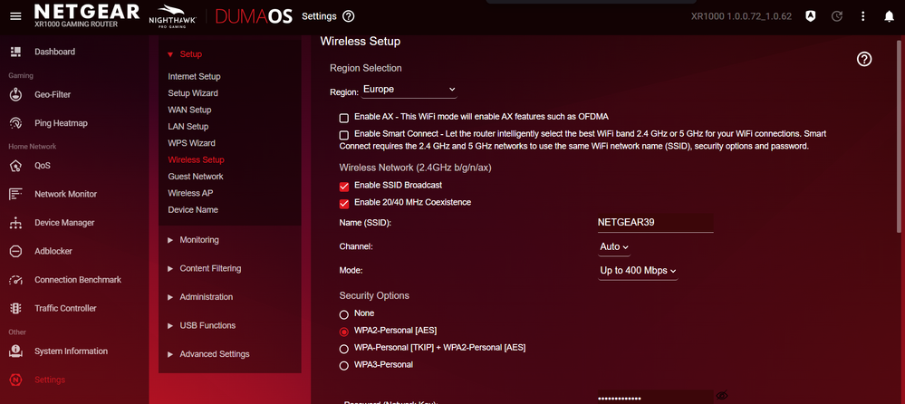

Thanks for your help, but my ping still fluctuates in XR while it's stable in HG. I'm not sure why—maybe it's a firmware issue. I updated to the latest version, but the 5G network isn't showing on both Samsung and iPhone. It only appears properly on my laptop, and on mobile devices, it's not showing correctly, while the 2G network shows up fine. I have the latest mobile phone both Samsung and iPhone. - Netduma-FraserOct 04, 2024NetDuma PartnerFor 5GHz WiFi change the mode to 2400MBps I think it is, then apply, do you see it working then?

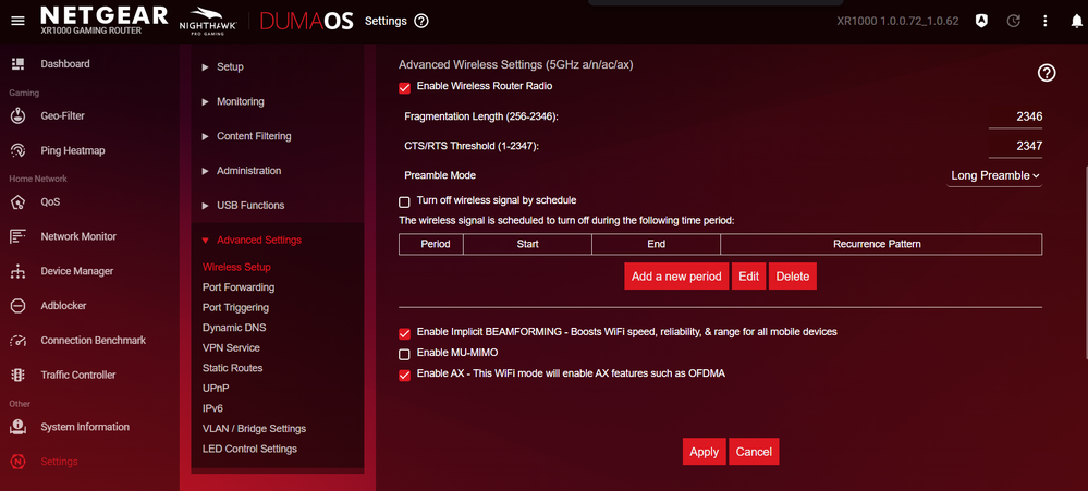

still not showing on mobile and working properly on the laptop I check all MBS 600 to 4800 - Netduma-FraserOct 05, 2024NetDuma PartnerChange it to the mode I mentioned, disable any advanced WiFi options like AX then reboot the router, does it work then?

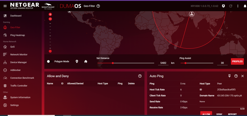

Forget the Wi-Fi issue for now, it's still not showing. Can you help with the geo-filter? I set the geo-filter, but I keep getting connected to the same server, which shows 5ms ping, and it automatically appears and disappears in the auto-ping tab. The IP 43.245.206.1 to 254. However, I'm experiencing bullet delay sometimes. Some days my internet works perfectly, but other days it doesn't. Enemies' shots register even when I'm behind cover. I've tried different tools to track the IP, and it always shows me that same address. Is there anything I can do to improve my ping to this IP? - Netduma-FraserOct 07, 2024NetDuma PartnerCan you provide a screenshot of the full Geo-Filter page showing what you see when you connect to this server please?

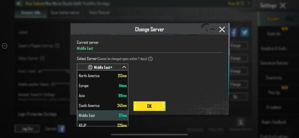

Does the in game ping reflect 5ms also? - ahmer_ali78677Oct 08, 2024Aspirant
The in-game ping ranges from 10 to 40, while in matches, the ping is 20. However, the geo-filter shows 5ms.

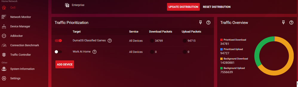

The traffic prioritization sometimes works when I start the game, but other times it doesn't. Why is that? - Netduma-FraserOct 08, 2024NetDuma PartnerYou need to set Ping Assist to 0 and also if it's the server within your radius then you'll always be able to connect to it, you'll need to adjust the radius to exclude it. I'm not sure how tested the game is so it would be better to add your device with the Games Console service and then it will prioritize the game more consistently.

- Netduma-FraserOct 08, 2024NetDuma PartnerThen you need to exclude that server from your radius so you no longer connect to it.
I don't mean switch the device to a Games Console, just add the device to Traffic Prioritization and select the Games Console option to prioritize.

Did you mean like this? Check the picture below—setting the games console to traffic prioritization.

I also reduced my area to exclude that server. I’ll play the game and see which server it connects to.

- Netduma-FraserOct 08, 2024NetDuma PartnerYes that's correct for Traffic Prioritization. You have to set Ping Assist to 0, if you don't, you will keep getting that server. Also if there isn't a server within your range you will not get a server. Disable the advanced WiFi options I mentioned before and try again. You may also need to change the channel depending on what is allowed in your country.

I set the ping assist to 0 and selected my country, but now it keeps connecting to the old bad server with IP 43.245.206.1, which is available in my country. Before making this change, I occasionally connected to the Singapore server, which had a good 5ms ping.

Also, if I disable advanced WiFi settings like AX, what’s the benefit of having AX in the router if I can’t use it?
Singapore server which I saved
- Netduma-FraserOct 10, 2024NetDuma PartnerIs that server within your radius? If so you will probably connect to it, only have the servers you want inside your radius with any other servers outside your radius. Move the location, adjust the radius size etc to achieve this - it doesn't need to be set to your precise location. They may be experiencing lag compensation, as their ping is so high so the game gives them an advantage to try and make it move even. More so to disable beam forming, mu-mimo etc rather than AX specifically.

already disabled - ahmer_ali78677Oct 11, 2024Aspirant
i disabled everything still not showing
