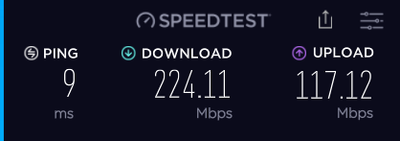

- TheSpartanNov 23, 2022Aspirant
When I tested it before to setup the router for the first time it didn't work. My ISP only allows their own router, so I set the MAC as the same as the ISP provided router, it didn't work but later my ISP added the default MAC address of the router to my account so it's working now. Can you look into my other issue, why the router doesn't limit Upload speed through congestion control and Bandwidth allocation even if i uncheck upload share excess. Checkout the screenshots. I have 10 devices connected at most concurrently but it usually 6 devices.
