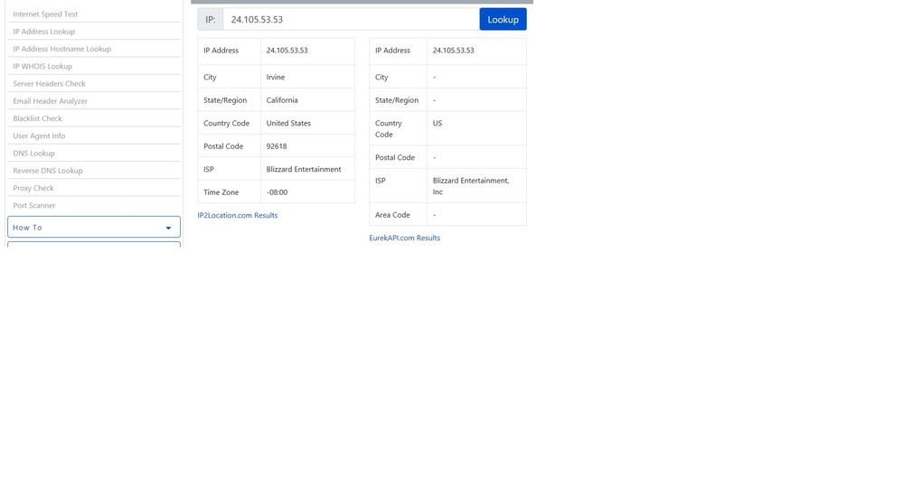

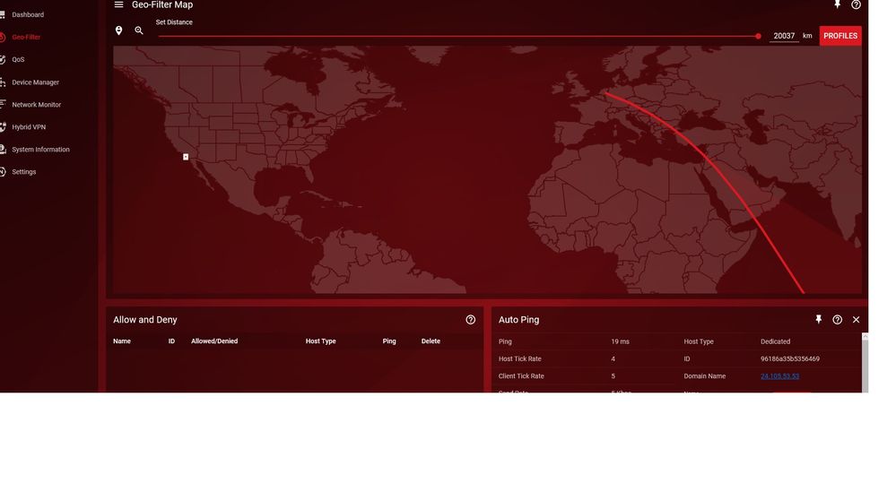

Hi can somebody explain me how i (Central EU basesd) can have a ping of 19ms when Geofilter connects me to a dedicated blizzard server in California?!
Does geofilter mindtricking me haha? (i did not lower my radius on purpose)
see screenshots

- Netduma-FraserNetDuma PartnerYour radius covers the entire world which is why that server was allowed. It's also misplaced on the map as it's a low ping it'll be a lot closer to you. You do not always see the players in the game on the map when connected to a server. Your ping to the host is what matters. Being able to see the players would not benefit you.

Information of the host might not be useful too. Because without geo filter. your psn will search for the closest server anyway. You can see that the map is misleading. And i was not joining a california based server. but a EU server (19 ms)
