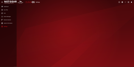

i recently purchased the xr500
after completing the initial setup i was taken to to dumaos dashboard and attempted to configure settings
however, on clicking the settings link nothing appears (se...

In Installed R-Apps option menu can you change retry attempts from 3 to 5 please. Then reboot and see if the pages are loading correctly after a few minutes please.

tried your suggestion
nothing changed

- angry55Dec 03, 2018Aspirant
Hello,
thank you for your assistance. much appreciated
before I downgraded / upgraded the firmware I tried disabling the adblocker
this allowed me to see the settings menu in dumaos
as a precaution I downgraded / upgraded the firmware as well
I have now setup an exclusion in the adblocker and all seem to be working ok
