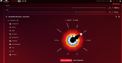

- Netduma-FraserFeb 26, 2024NetDuma PartnerOkay great so how do you have QoS set normally - can you provide an attached file of a screenshot please?
