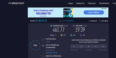

I pay for 1gig download through spectrum, recently got all cable lines redug cause was high latency issues and it was busted. Everything was tested all the way up to the cat6 cable from modem to rout...

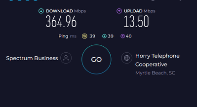

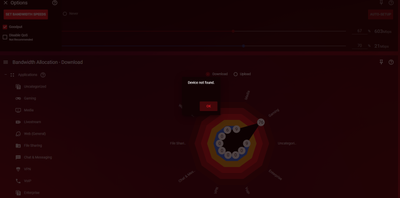

TRAFFIC PRIORITY ISNT LOADING RN BUT THIS IS SPEED TEST RN WITH HOW THIS IS SET. KEEP GETTING THE DEVICE ERROR, BUT POSSIBLY BECAUSE IVE RECENTLY BEEN CHANGING BETWEEN ETHERNET AND 5GHZ FOR TESTS/GAMING ETC. HAVE MY NAME FOR BOTH DIFFERENT SO CAN TELL THEM APART FROM ONE ANOTHER WHEN SETTINGS QOS OR GEOFILTER. Netduma-Fraser

With QoS on and Congestion Control set to Always it will always throttle the speeds to the percentages you've set so set it to Auto to only apply when gaming. Yes click reset distribution - gaming doesn't use much bandwidth anyway. We don't do live support or anything like that, just through forums/socials. The live support will have been from NG and not from us who made DumaOS. That error will have happened because you had a device added to Traffic Prioritization that you then deleted from the Device Manager at some point. You'll have to factory reset or re-add the device via the same connection method, give it the same name/device type to clear the error.

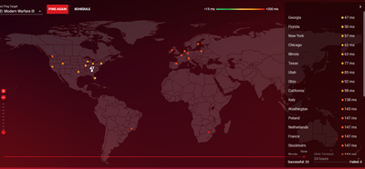

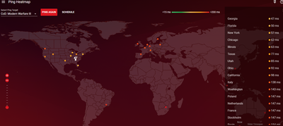

getting high ping in game always at 45+ its obviously manageable but anyway to get this to decrease into 10s, 20s, even 30s? I have spectrum and pay for 1Gig download should be at 30 upload.

- Netduma-FraserMar 15, 2024NetDuma PartnerPing Heatmap indicates that's the lowest ping to servers that you're able to attain, if you connect directly to your modem what pings do you get to games? That will give you an indication of if it can be lowered any further
