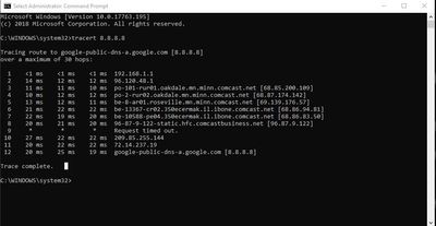

ive done a test in cmd tracert 8.8.8.8 and these are my results im not sure if i have double nat or not maybe you can help
- Netduma_JackJan 07, 2019NetDuma Partner
Simplest way of testing double NAT is through the console's network test.
