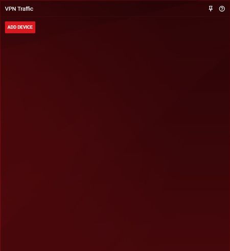

Need Assistance for Setting Up the Netgear XR500 for protecting my Livestream from DDoS via Xbox One
I am at a loss. Here is my setup.
______________________________________________________________________________
Verizon FioS ISP (100up/down) directly connected to Netgear XR500 Router.
Attach...
Netduma-Fraser
Apr 21, 2019NetDuma Partner
On the device manager you need to give your PC the device type of a PC and not a console, that will then allow you to add a service on the VPN Hybrid. On OBS on the output tab what is the stream type, is it RTMP? If so that uses TCP 1935 so if you add that as a service that should allow your stream to go ahead without being behind a VPN. Also for the VPN server make sure you're selecting the closest possible server to your location, that way you'll experience less latency on the devices behind it.
- jsg877Apr 21, 2019Aspirant
I'm only getting validation errors for 'sport' now. I can't seem to get the Port Ranges for Source and Destination correct. I understand its RTMP and that needs a rule for Port 1935. What range for the Source Port should I be using? And what range for the Destination Port?
- Netduma-FraserApr 21, 2019NetDuma PartnerI believe I just answered your post about this on the Netduma forum. Leave source as it is then do dst 1935-1935
I was actually able to figure it out shortly before receiving the answer. Yes, you're post did lead to 99% of the solution. The Source Ports were not inputted as a default at all, so I just had to input 1 - 65535 for Source. 1935 - 1935 for Destination.
