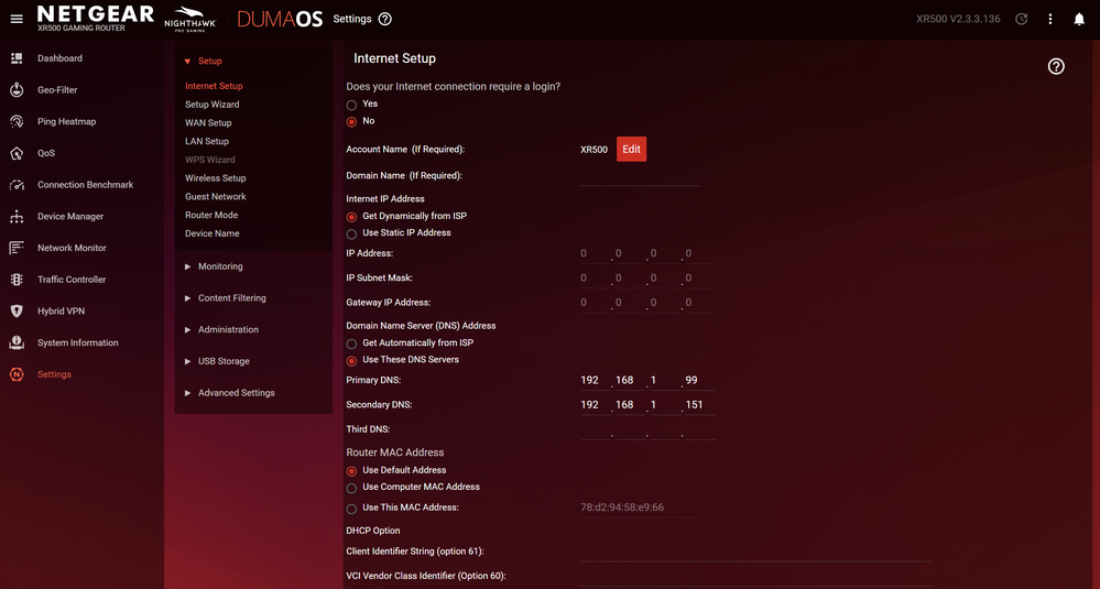

- FURRYe38Sep 04, 2025Guru - Experienced User
So this works for me on my XR500 that i already had out on my desk.
Setting Default IP address range .100 to .150:
I just entered in some IP addresses outside of the new default IP address range and hit apply and didn't get any conflict messages:
Those IPs I tried didn't have any connection, just wanted to see if an LAN side IP address would work and it did. I presume this should work on the XR1000 as well since should be same base code.
