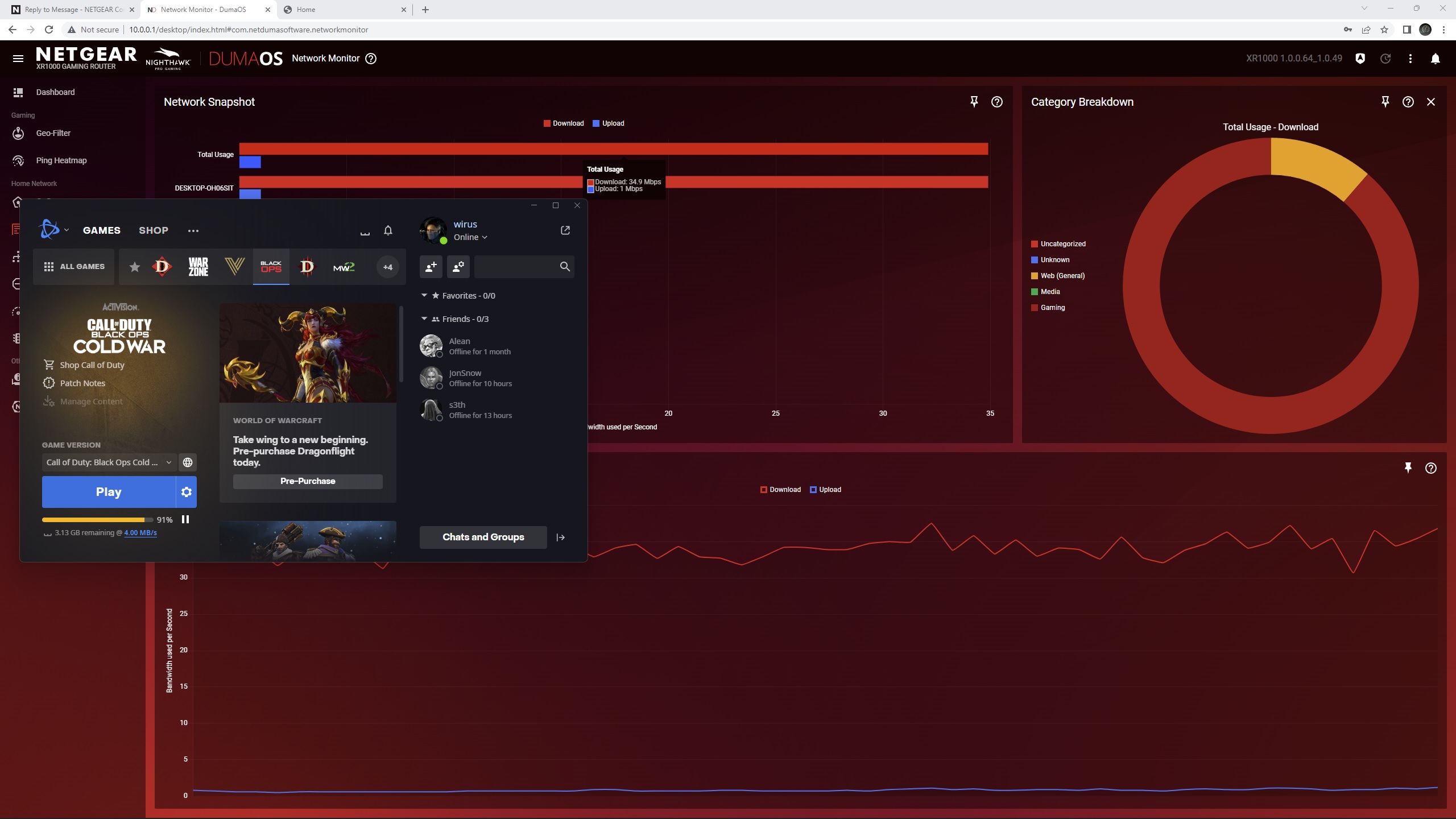

- WirusOct 05, 2022Tutor
Looks like the bandwidch is used somewhere inside the router.....or i don't know....but as u can see in the print screen on Network Monitor i do get the full band but for some reason it is being usewd somewere else. or am i wrong?
