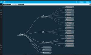

Network Map is just plain wrong.
My network map shows only 1 device on 2.4GHZ and 1 device on 5GHZ.
All the ones on the EX8000 show as wired (I raised that in another post, so ignore for now)
All other devices show as Of...

Hi - sometimes the Network Map can take 30 seconds or so to update when a device is online. Could you check it again to see if it accurately shows them now.
The wired appearance of the extender is something we know we need to fix. As it's a visual issue it probably won't be done in the near future but we will look to solve it soon.

I've figured out the offline devices thing. Any wireless devices connected to the EX8000 are showing as Offline, which is obviously not correct.
