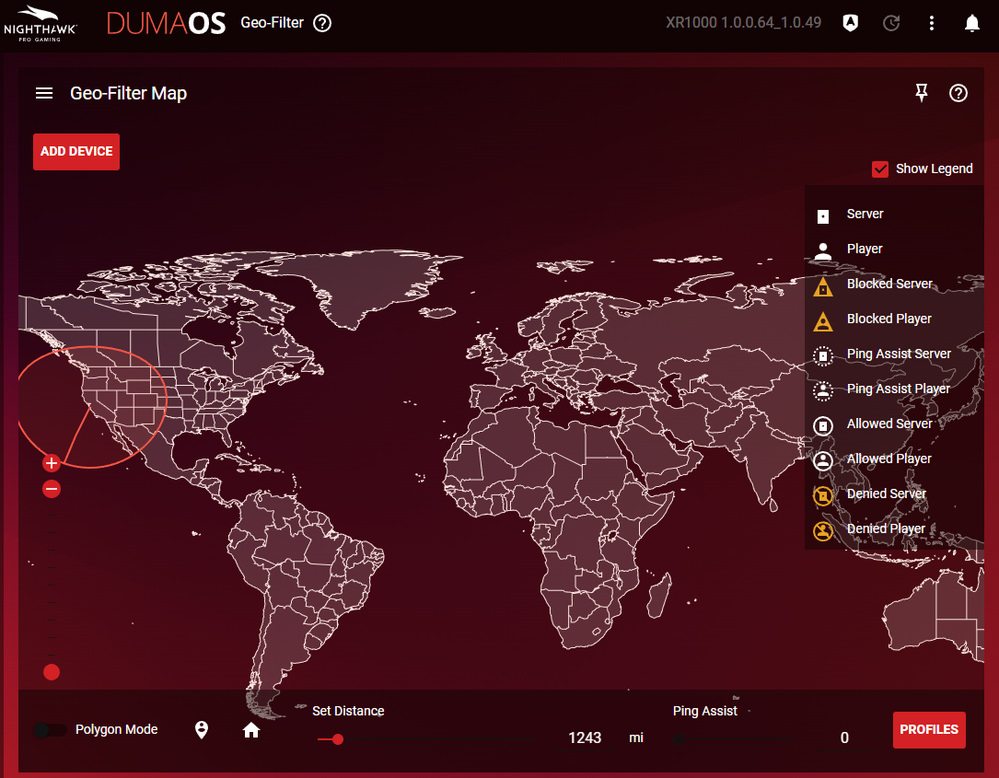

Redid all my settings and drew a line of my search area in geo-filter inside North Dakota and did about a 700 mile radius. Fast search toggled off with QOS Toggled Off.
I was still getting into lobbies outside my search radius. It's not blocking anything outside the search area.

- Netduma-FraserJul 22, 2022NetDuma PartnerCan you provide a screenshot of your Geo-Filter page please? What do you mean QoS won't enable exactly - can you provide a screenshot of that page as well please?

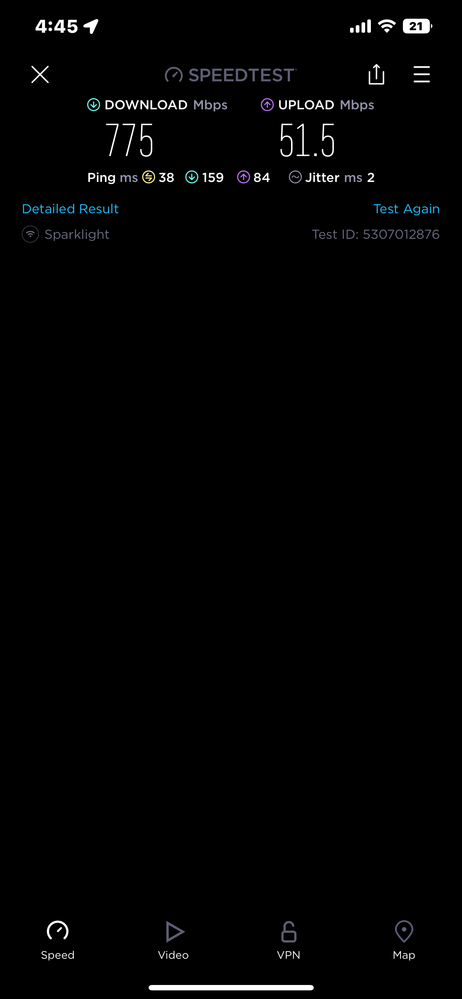

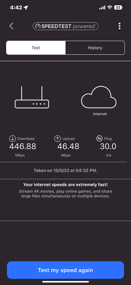

Nighthawk app on iPhone 12 pro max iOS 16:
2nd test after capturing this data got even worse: 372 on the down.
I'll check again later this evening. I presume this maybe a NH app speed test or the router picking a slower test site?
I get over 900Mpbs with the same NH app and iPHone and a RAX series router connected to same modem

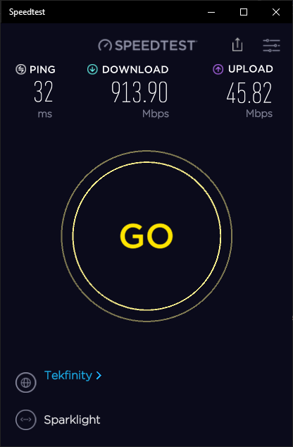

Ooklas app on iPHone 12 pro max iOS 16:
Ooklas app on wired PC Windows 10x64:

GeoFilter:

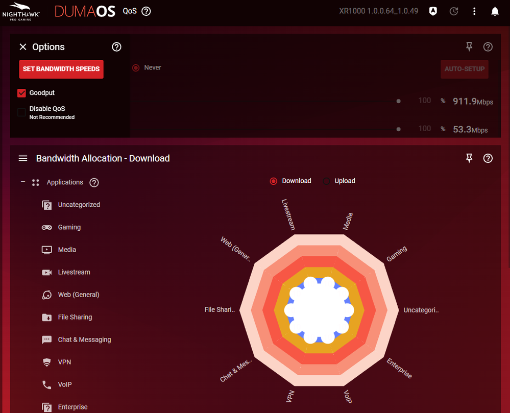

QoS Enabled and working:
