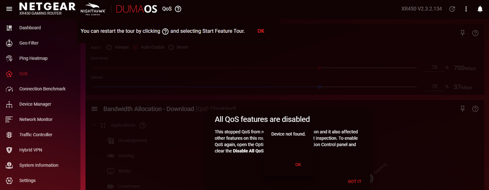

when i click the QoS option i am greeted with a device not found, also when i try to run the connection benchmark nothing happens

i tried the hard button reset on the back, held for ten seconds. it rebooted the router but saved info was still there, then i did the factory erase option(think that is what its called) and that did reset it. so long answer is yes. I have also tried both chrome and edge
- Netduma-LiamApr 14, 2022NetDuma Partner
You may need to downgrade back to .130, factory reset, then upgrade to .134 and don't reset. That'll fix it for you.

The "Device not found" message appears on the QoS page:

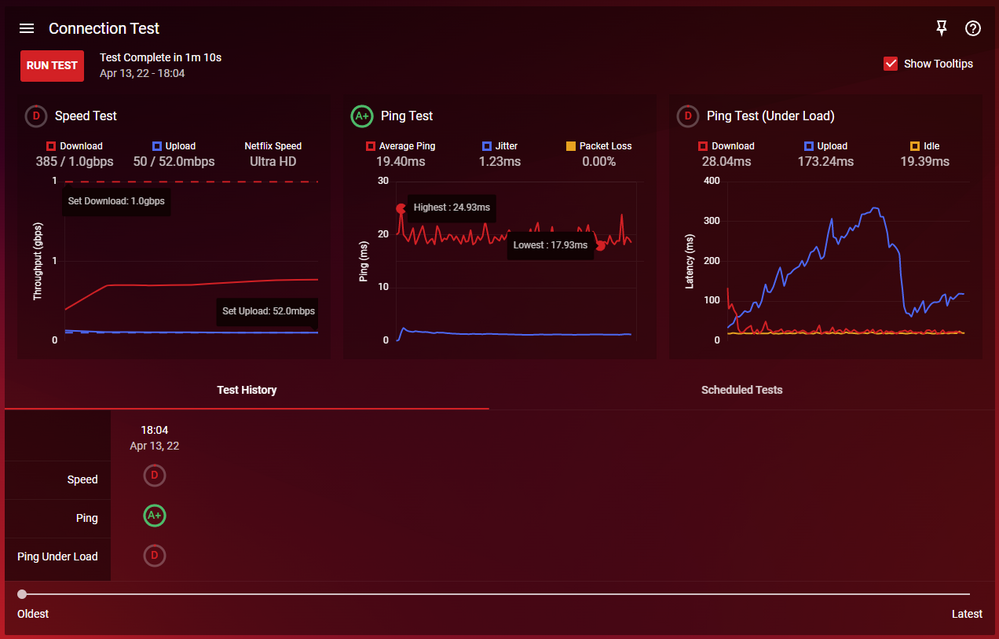

Connection Test is working however the download doesn't reflect what external speed test app says:
