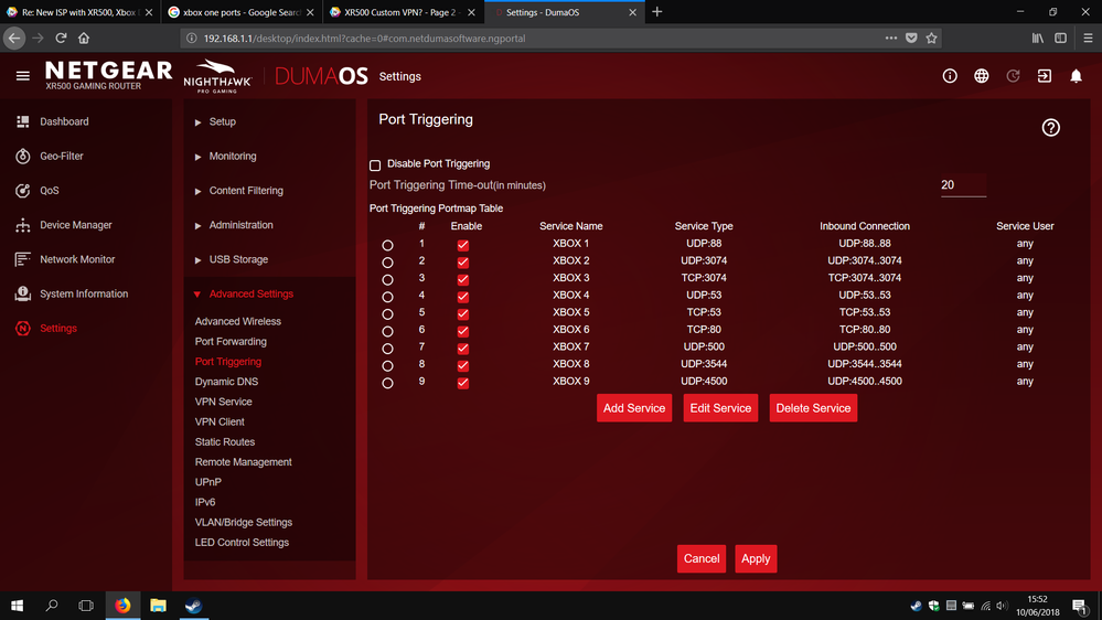

as th
I fixed my the nat issue with the xbox by putting all the xbox ports into port triggering and left the specific i[ blank so it covers both the xbox,s
you may have to add some ports twice as they cover both UDP and TCP.
These ports must be open for Xbox Live to work:- Port 88 (UDP)
- Port 3074 (UDP and TCP)
- Port 53 (UDP and TCP)
- Port 80 (TCP)
- Port 500 (UDP)
- Port 3544 (UDP)
- Port 4500 (UDP)
- wub901Jun 10, 2018Guide
This is my port triggering setup not sure if I set it up correctly but I get open ports on both the xbox,s the ps4 i put in the DMZ
MY SETUP
the gui issue can be fixed by switching the language to another then back to english once it has updated.
