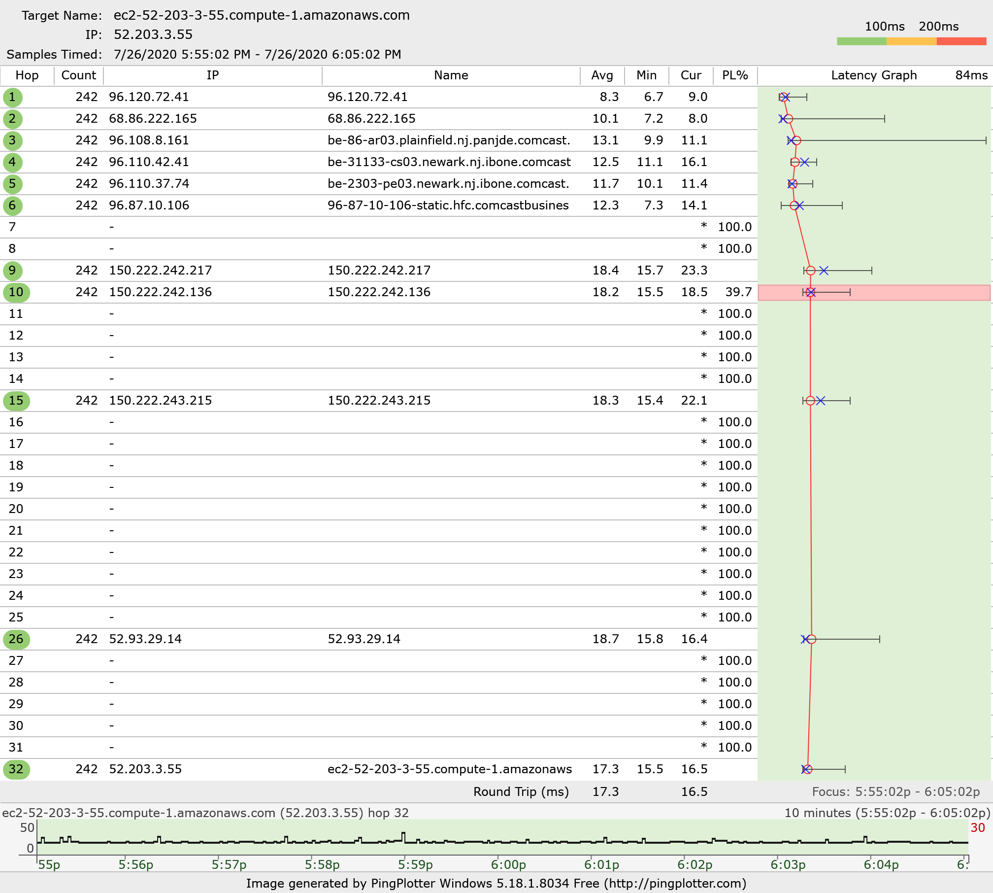

Here is the Fortnite Ping Plotter results only connected to the modem via ethernet.

- DirtySZNJul 26, 2020Aspirant
Here is the Fortnite server plot connected to the modem only -
