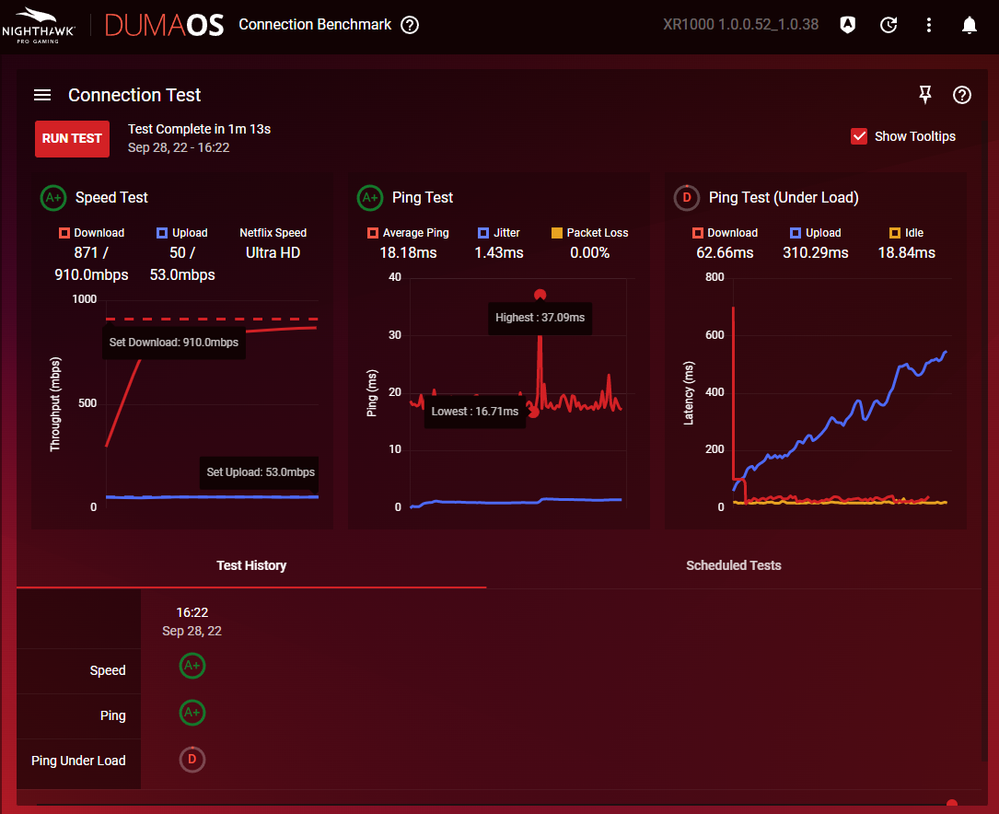

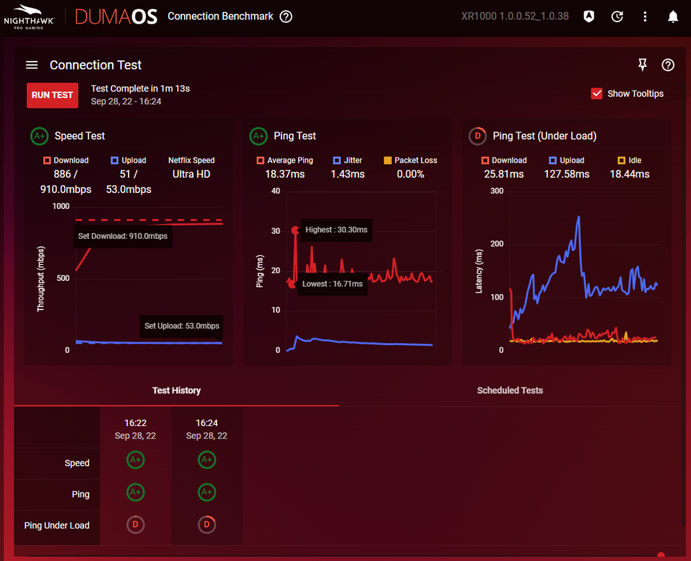

After I got my XR1000 set up yesterday I saw similar on mine. Seems to spike at the beginning of the test then drop off. I just presume this normal at the beginning of the test and a load up of data then levels off as the test continues.
I left my router at v.52 that came loaded on it.
I'll post pictures later of what mine showed.
- FURRYe38Sep 29, 2022Guru - Experienced User

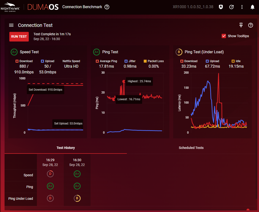

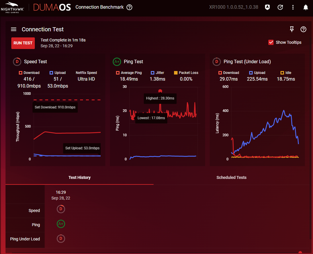

Heres my XR1000 v.52 connected to a CAX80 in modem mode.
With QoS enabled:
With QoS disabled:
Seems like there was some delay in getting the 1st speed up to par after the router rebooted and was back to ready, as why I did a 2nd test.

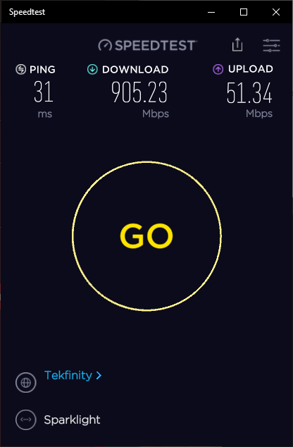

WIred speed results on Windows 10x64:
